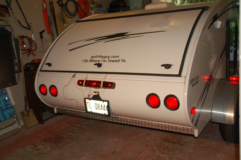

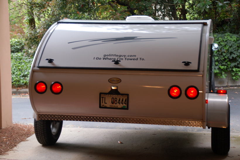

Postby wlooper89 » Mon Apr 20, 2009 3:23 pm
This photo shows the rear ID light bar temporarily attached in a possible location. This would certainly be the easiest way to do it. The bar just covers the Little Guy logo so I would not need to remove it. The actual position would be about 1/2" lower. Perhaps I can get another logo sticker to put somewhere else.
I was wondering if this location would be near enough to vertical. It would be nice not to have to move the license plate mount. I will very much appreciate any thoughts or comments on how this would look, or if you think another position would be better. This link shows the back of my trailer without the light bar for comparison. http://tnttt.com/album_ ... c_id=49101
Bill

Postby Esteban » Mon Apr 20, 2009 5:00 pm
:thumbsup: The placement of the bar light looks good to me. :thinking: When you stand back in the dark how well does the bar light illuminate to warn someone who'd be following you? :thinking: BTW, does your new light have a braking warning function?

Postby wlooper89 » Mon Apr 20, 2009 5:41 pm
Steve,
Thank you for your comments. This 3-light bar is just for 80" wide trailer ID and it is on continuously when the running lights are on. Not connected with the brake lights. The lamps do seem a bit dim to me. The basic function is to let another dirver know this is a wide vehicle. While the front and rear clearance lamps on the fenders indicate the widest point. These lamps are only required for trailers 80" or more wide. The third high mount brake light is not required on a trailer but might be a good idea. This 3-lamp bar is just to make me legal with my 90" wide trailer.
