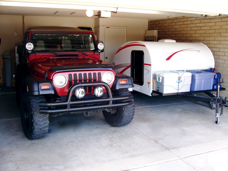

Ahh yes, the platform of a Lil Guy tear - you can do so many versatile things with this. Take your time and think your needs through. I'm sure Hiker Chick will chime in on this too as her quest for the perfect trunk led her in yet another option for you.
Now, you have a 5 wide and I have a 6, but still here ya go. I have a Coleman Extreme cooler on one end. I use my platform for preparing food under my side awning (pics to be posted later). I also tuck my ground mat and a flat table securely behind the cooler. In the middle is a rubbermaid container that at the top measures 19 X 27, but the beauty is it tapers down at the bottom to fit the 16" platform perfectly. I store my porta potty and all things related in there along with extra 1 pound propane bottles. I place the flat table stored behind the cooler on top of the rubbermaid for the grill and food prep. On the far end is a Reliance Water Jug, 8 gallons of water to be used for showers, dishes, etc. Everything is secured to the rack with tension locks, bungie cords, and the water jug with a heavy duty lashing strap . All have very easy access.
This is is a very functional area of my Lil Guy as all of these things are exactly where all the action is for me in my set up, and that is in the front and on the side, not the rear like most others. That's the beauty of these things, each is basically a custom job to the flow of your camping preferences.

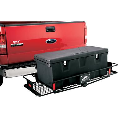

Were I looking now, I'd also check out this new plastic box Cabela's is selling. Website doesn't list the weight but I'd imagine it's pretty light.
Cabelas - Poly Hitch Hard Box
Item:IK-523511
$169.99
The all-purpose solution to your storage needs. This large-capacity, low-profile chest is constructed of heavy-duty, impact-resistant polyethylene. It can be mounted to the floor of pickup beds, trailers and garages. Overlapping lid design seals out weather. Top-opening lid with zinc hasps. Stainless steel hinge. Built-in carrying handles. Made in USA.
Capacity: 8.3 cu. ft.
Dimensions: [b]44"L x 17"H x 19"W. [/b]
http://www.cabelas.com/cabelas/en/templ ... hasJS=true

scott: man i just looked at the extreme cooler by coleman, and i like the way yours fits the plartform
and hiker chick , i really like that cabella's box also. thanks again you been a gret help .

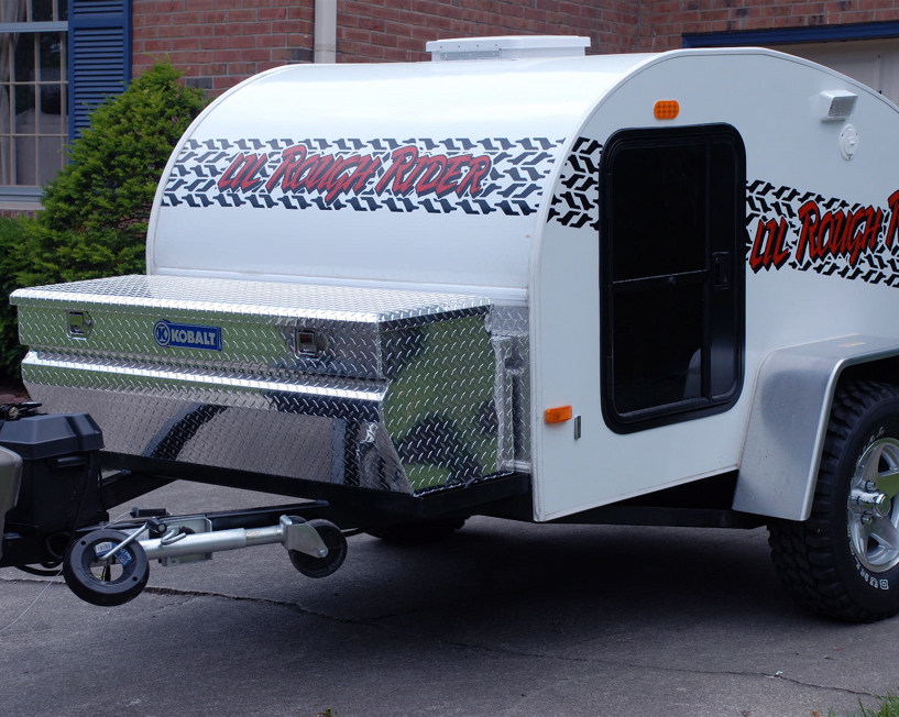

I really struggled with this decision myself. Finally, after exploring several other options, I decided I wanted to purchase a lightweight, locking, weatherproof tongue box. I wound up with this one from Lowe's:
Like Hiker Chick, I painted a couple of 2x4's black and mounted it on those. The bottom fits down in the platform frame, but only about a 1/4". The width is 57". This thing is cavernous: it holds my Coleman stove, a step-stool, a porta-potty, a Reliance water jug, a small tool kit, etc.
I priced these all over and decided to go with the Lowe's model because I got a 10% military discount there. Retail was: $268 at Lowe's, $249 at Home Depot, $395 delivered from Northern Tool, and, the best deal, $219 at Autozone. I didn't see the one at Autozone until later.

oh yea , John, ive seen those at lowes too, theres one 3 blocks away from my house.

Postby iOpine » Mon Jul 20, 2009 10:19 pm
That's where Little Guy mounted the deep-cycle battery. I thought it was strange, but it certainly is handy. Since it's so close to the hitch I don't think the weight of the battery should be included when figuring hitch weight to gross weight percentage.
Tongue weight empty with that battery there is ~165 lbs. Tongue weight fully loaded is about 230 lbs. (I stash 160 lbs. of gear behind the axle in the hatch and "trunk," which only partially offsets the 126 lbs of a fully loaded tongue box since it's much closer to the axle. Yes, I weighed all the stuff.)
The V8 4Runner's hitch is rated at up to 700 lbs and she sits almost level front to back when hitched to the TD. (it usually sits an inch higher in the back.)
We have no trouble with trailer sway in any conditions, including steep mountain roads and offroad. And in spite of a tongue weight higher than 10% (but less than 15%), with this combination handling is exceptional.
Fully loaded trailer weight is ~1750 lbs. This TD has a heavy duty frame with steel skid plates.
It also has heavy 31" MT tires. I load an additional 300 lbs of gear in it for an extended trip. Again, this combination wouldn't work well with some vehicles, but works great with mine.
