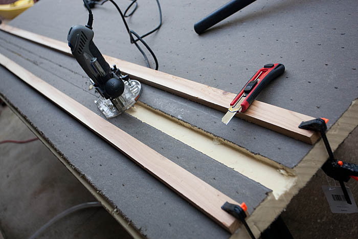

Hi, I have started the build as a separate thread. After finally getting together enough materials, I have begun my build. You can find a full collection of photos in my gallery at http://www.mikenchell.com/forums/album_personal.php?user_id=8732
So, the idead was to build a lightweight, expandable teardrop. After some thinking and research, I found a product called ISO board, commonly used for roofing. It is an extremely sturdy foam that comes in 1" to 4" thicknesses. Each side is covered with a fibrous paper. My idea is to epoxy the outside with glass mat. the inside will just have epoxy. The attached paper readily soaks up the epoxy. Whle doing this, I will also embed supports and roof tracks.

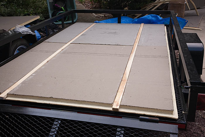

I am using a Carry-On trailer with a perimeter rail. My thought is to bolt glue and bolt hte construction to the rails.

Looks like your off to a good start. From the pics...it looks like it cut real well! :thumbsup: :thumbsup: :thumbsup:

Thanks. I did mess up the edges a bit since my Dremel wouldn't cut to the depth I needed. So I continued with a razor. Bad move. I tore it up!!!!
So, I will have o smooth it out later.

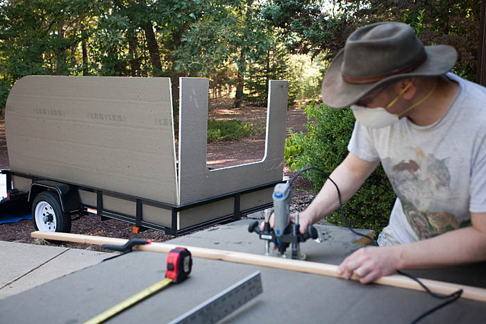

ISO build continues...
Postby TomsTwin » Sun Sep 06, 2009 8:05 pm
Hello All,

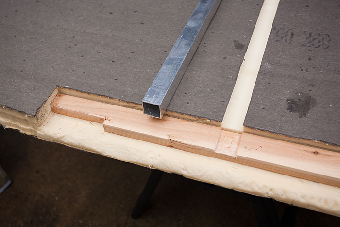

After bad weather delays and general busyness, I have gotten some more done on my ISO board foam insulation trailer. I have rethought the roof extensions and have cut channels in the flooring and side walls. Here are a few pics. More are in my gallery...
GlassIce... Thanks for the advice on adding 1/8" holes. Furtonately, I haven't epoxied any major portions yet.
Once most of the pieces are cut and fit, I will come up with a strategy for glassing and piecing together.
Thanks... Tommy

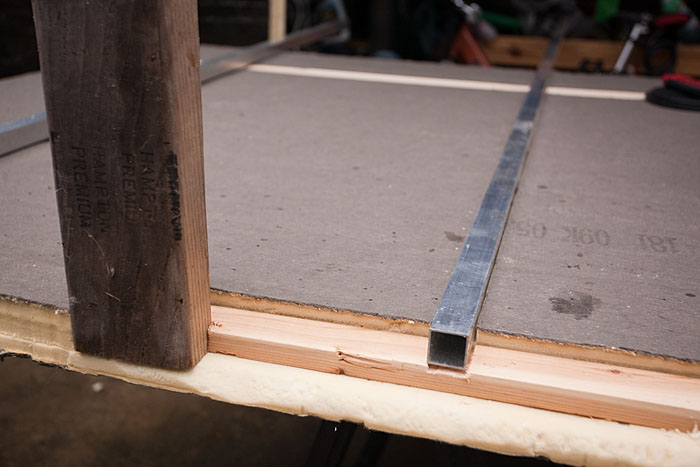

Postby kennyrayandersen » Mon Sep 07, 2009 7:03 pm
I’m not exactly catching your corner joining method, or why you imbedded the wood strips (going to screw something to that later?). As you have noticed, the foam is brittle, and the small exposed edge, after you router, is very prone to cracking (you should be able to stuff some glue in there and use a bit of scotch tape to temporarily ‘clamp’ it.

Postby TomsTwin » Mon Sep 21, 2009 4:50 pm
Hi kenny,
The corner above is actually a bit of a mistake. This has become the back of the trailer. It is about 1" too long, so that one rabbeted edge will be removed. I will post a close-up of the wall-floor joint in about a week or so. I have already had to patch some cracked edges with epoxy, so I am quickly learning about the brittle-factor. Oh well...
Also, I am embedding wood strips into the foam for bolting to the framee. I will coat the bottom of the floor with rubberized roof patch and also bolt it through these strips to the trailer.
I have done something similar with the side walls and will bolt throught he wood to the trailer side rails.

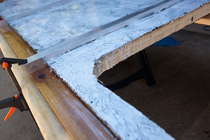

Postby TomsTwin » Mon Sep 21, 2009 6:06 pm
Hello all,

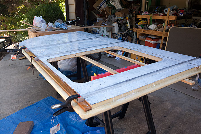

I finally got to the point of epoxying the first wall.

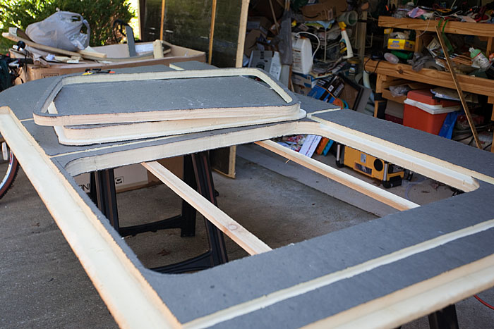

After cutting all the channels for the Aluminum tubes through foam and wooden wall supports...
I checked the fit for the 2"x4" wall cross beam...
This beam will sit over the galley wall and act as a support for the galley huricane hinge.

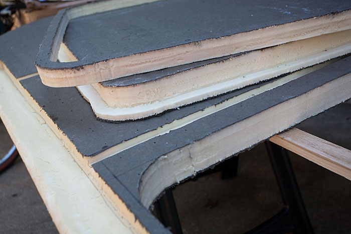

With all pieces fit together, I cut out the door shape. I then cut out a 1.5" x 1" rim from the door to glue back into the door opening. This rim will act as a seal placement and a drip ring.
a close-up...
Finally, I epoxied the inner side of the passenger wall. The final coat was died white.
A close-up of the door opeing corner with rim glued back in place and glass mat at corners.
That's the progress thus far. I hope this all works and doesn't blow apart on those Montana highways.
