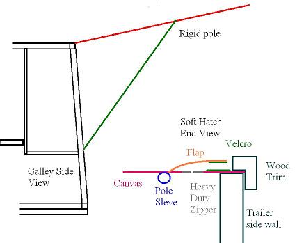

I'm all for it!! You going to have a frame or snaps like on a boat to hold it in place?
As for security, I don't know what you would be carrying back there but I never have anything of value anyway. If a bear wants my food, canvas or wood isn't going to stop it.
We would all like to see some scatches or pictures of what you are thinking about
John :thumbsup: :thumbsup:

Postby Forrest747 » Thu Sep 17, 2009 12:29 am
Here is the sketch of what i am thinking. Will goto a local canvas guy that does custom for boats and get his input. Taking alot of it from the 97 Jeep wrangler a heavy duty zipper that has a velcro flap that covers it. I was also thinking of doing a sleeve for a rigid pole to create an awning. Going to get the canvas guys opinion yet thinking of tacking it down and then covering the edge with a wood trim. Wife also suggested maybe have it fold out to make a larger awning. we shall see I love her thinking though.

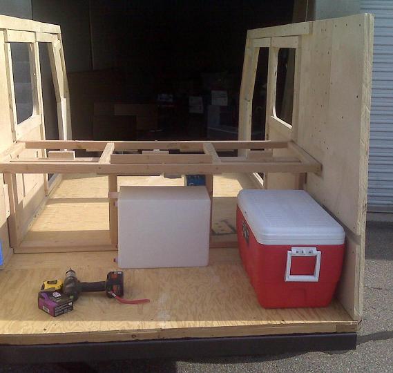

Postby starleen2 » Thu Sep 17, 2009 9:02 am
Question for Ya': What's the clearance on those tires to the fenders? it looks kinda close to me. I'd be afraid that a good bump could cause some tread shaving
starleen2
5th Teardrop Club
Posts: 16272
Location: Pea Ridge ,AR
Postby Forrest747 » Thu Sep 17, 2009 5:16 pm
the fender clearence is 2 inches and yes it has caused me some concern. I do plan on trimming it once the build is complete and i fully load it it see how much to trim.
Its nice to have such good observations from people.

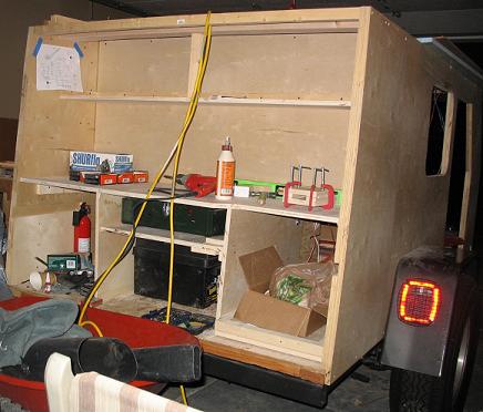

A little bit more done on the galley
Postby Forrest747 » Wed May 26, 2010 4:29 am
Still thinking canvas and have talked to a couple of awning companies that do boat covers. looking at material it will be about 75 to 100 dollars plus labor. Cant think of it being to complicated.
The plan is to use Jeep cargo nets instead of cabinet doors, sink on the left hand side, the box is sitting on the slide out cooler rack. On the upper shelf area on the right hand side will be the stereo. Battery is getting a bracket to prevent from sliding around. Use the area underneath the sink for camping chairs and such, with cargo nets on the lower shelfs.
This is keeping me occupied and mind off stuff.
