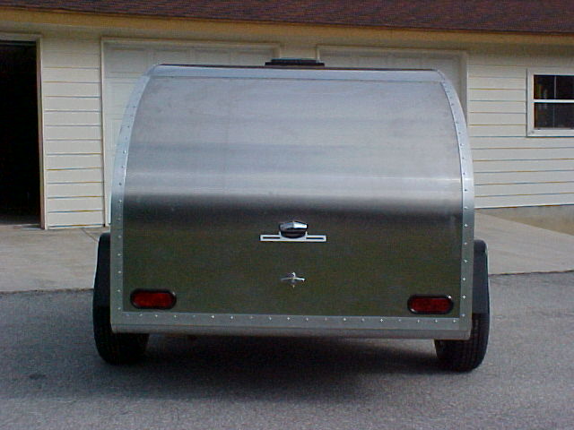

What I did was when I built my hatch, I built the ribs the same curve/size as the walls, covered the frame of the hatch with 1/4" ply that did not go past the hatch frame, and then installed a 1/8" X 2" aluminum molding from Lowes on the hatch that stuck out over the walls, and then put the rubber seal in between to fill the gap.
Sounds complicated, but it was easy. This is how it looks:
SteveH

I got my hinge, a teardrop non leak type, from George at the Teardrop Fixit Shop in Montana. It is just like the one you have except it doesn't have the vertical aluminum parts. It is flat like a normal hinge.
My hatch does not leak at all. I was in a major thunderstorm coming back from Louisiana last Sunday and no leaks.
