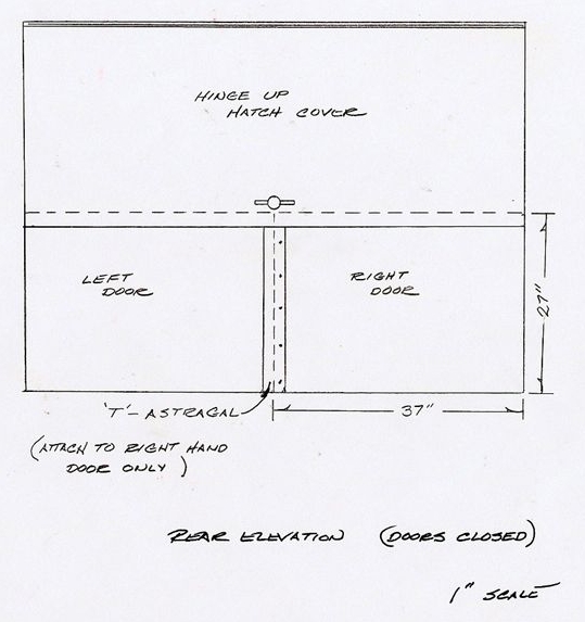

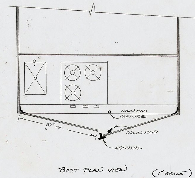

I have the typical weekender galley hatch but I also have two 21"x28" doors in back that swing outward. The galley hatch overlaps these doors to make the whole thing water tight. I can't figure out what type of latches to use for this arrangment. By latches, I mean doorknobs, only not doorknobs. I would like to use individual latches for the doors and a seperate latch for the hatch. Does anybody know if this is possible to do and how would I do it/what type of latches.

Postby 48Rob » Wed Mar 31, 2010 6:53 am
If the two lower doors latch into the floor via a pin, the hatch can then latch via pins on the sides, into the sidewalls.
The bottom doors could be done with "T" handles, flush latches, or even a pin that drops straight down from the top, to be covered/protected by the hatch.
The hatch should attach with a lockable handle.

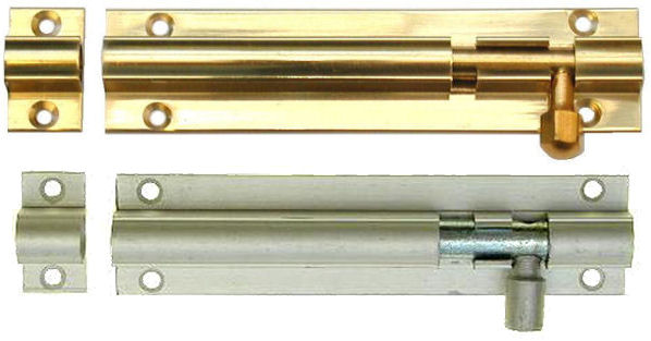

Postby Miriam C. » Wed Mar 31, 2010 7:14 am
If you want simple you can just use barrel bolts into the bottom and side latches for the hatch or even a single one attaching to the doors. :)

Postby timlsalem » Wed Mar 31, 2010 7:27 am
Not too sure what barrel bolts are. Are they the things that are usually used on the bottom of french doors?

Postby bobhenry » Wed Mar 31, 2010 8:04 am
timlsalem wrote:Not too sure what barrel bolts are. Are they the things that are usually used on the bottom of french doors?
That "OH one of those" moments........
Postby timlsalem » Wed Mar 31, 2010 8:45 am
Thanks everyone for the great ideas. :thumbsup: I can take it from here. I like the barrel bolt idea for the doors and a key latch for the galley hatch.
