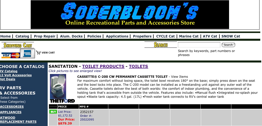

Postby Miriam C. » Fri May 14, 2010 7:16 am
Postby cuyeda » Fri May 14, 2010 8:59 am
The picture Miram posted looks like it could be a Thetford cassette toilet, mounted in the shower pan enclosure. If it is, it would eliminate the logistics of plumbing a black water tank. If only I could find the cassette toilet for sale in the US. I have tried and failed to find one available to the consumer.

Postby aggie79 » Fri May 14, 2010 11:37 am
starleen2 wrote:
Miriam C. wrote:Image
http://rvtravel.com/blog/rvnow/labels/Bathroom.html
Perhaps this will help. :D
I've seen the shower pans and toilet mount combo units - you buy the pan and then mount your toilet to it. What is shown surely would be nice to drop in as one unit. I have seen that page before, however I cannot find a link for them - I believe that discussion was earlier about the same set up but no one found a manufacture stateside for em'. :thinking:
That unit - at least the toilet portion - is made by Thetford. This unit has a cassette for waste disposal that is accessed outside the trailer through a door. You don't have to carry it through the camper. I believe they also have two options for water supply - plumbed or self-fill.
Many others have looked, but haven't found a US distributor. If anyone puts together a list of interested buyers, please sign me up (of course depending upon cost.) I'm interested in this for #2 (a standy.)
Postby CliffinGA » Fri May 14, 2010 3:49 pm
My question couldn't you get that unit from like forest river or one of the other manufactures as a replacement unit for a pop up?
Cliff :thinking:
