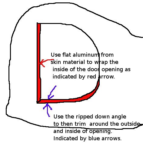

Postby toypusher » Thu Jun 09, 2005 10:21 am
IraRat wrote:
toypusher wrote:Ira,
Remember that the 1/4" smaller is measured AFTER you have the opening trimmed out completely! Otherwise the trim will take away from the 1/4" and them things might be a little tight!
Kerry
Thanks, Kerry--and therein lies (lays?) my confusion:
I have no idea what this trim is supposed to look like or how it's installed. In the Cubby plans, it's kind of hard to see exactly what's going on--especially in the black and white printed version of the plans. Plus, those plans don't call for a lip like that anyway.
MAKE SURE YOUR CAMERA IS FULLY CHARGED, GREG! I NEED VISUAL AIDS ON THIS!
Ira,
On page 38 (in my copy of the plans anyway) there is a picture of the door trim with an explanation of how it is done. What it does not seem to indicate is that you put a piece of aluminum flat on the inside of the opening all the way around and then use 1/2" x 1/2" angle with one side ripped down to 1/4" (the narrow side to the outside and to the inside, depending on which side of the door you are doing) to trim the opening and the outside or inside skins.
Maybe this sketch will help:
toypusher
Posts: 43040
Images: 324
Location: York, PA Area
