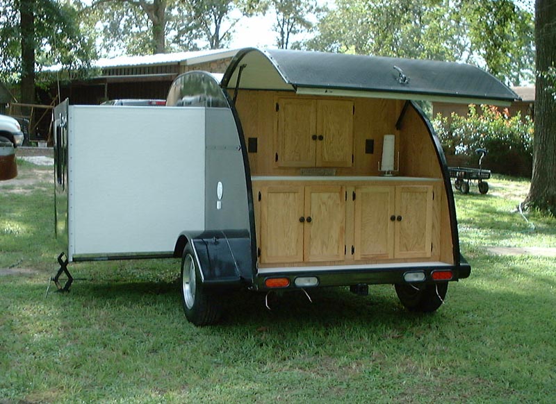

http://tnttt.com/album_ ... ser_id=472
Coca Cola teardrops did a slide out that worked wonderfully.
I am sure they would be happy to share info with you.

The slides on CocaColaTeardrop's trailer are "underslung" in that the slides are on the bottom side of the frame rails. They are connected to the slideout "tube" at the front. This really is the only way that I can see how to make the double seal work.
