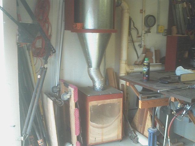

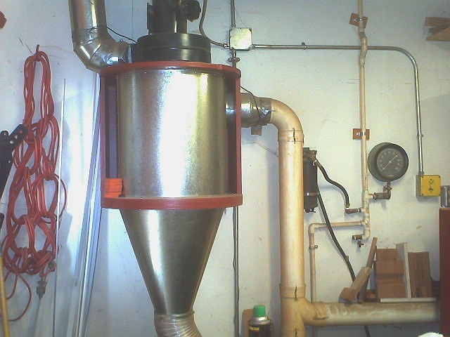

After using my surface planner for the first time, I soon realised the importance of dust colletion. I built this cyclone years ago and never regreted it
I have it hooked up to my table saw and jointer with extra ports for other machines via 4" plastic pipes. A note to anyone that wants to do this is make sure you have the tubes grounded. If you go with plastic (pvc) like me, I ran a bare copper wire inside for a ground. Vacuum creates static electricity and any spark can ignite the fine dust particles in side.

Postby cuyeda » Mon Mar 14, 2011 12:15 am
Rick,
Nice collector! I wish I had room in the garage for the 60 gal. air compressor, let alone a nice dust unit like yours. I can't tell from the photo. Is that PVC used for the compressor line?
Cliff & Vanessa
cuyeda
Posts: 1924

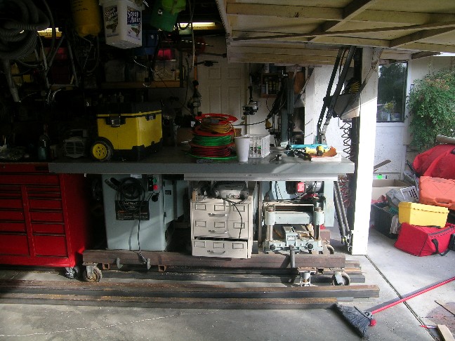

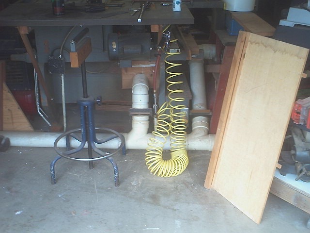

Postby satch » Mon Mar 14, 2011 7:14 pm
The small 1/2" line runs down to a 12 gal air compressor, the 4" is the vacuum tube for the cyclone.
Here's afew more pics
Here's where they hook up to the machines
It's abit messy in my garage, but it's the only way to work!
