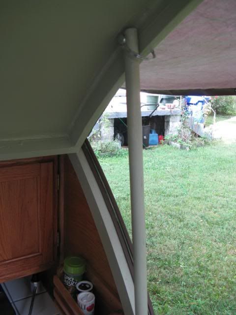

Original broomstick supports:

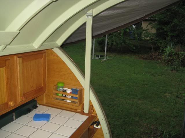

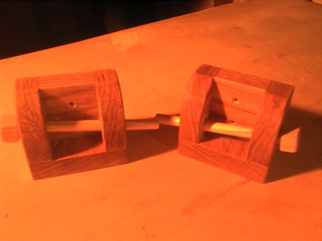

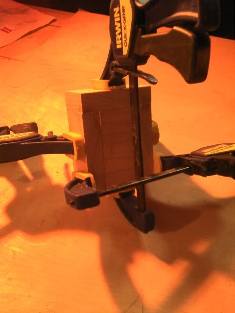

My wife is not blessed with upper body strength and she had some trouble with holding the hatch open and installing the broom handles by herself so I decided to go with a hinged design that hinges at the top. When the hatch is opened, the supports can swing down and fall pretty much in place. Out of a scrap piece of red oak 1X I made "receivers" with a pin to hold the uprights in place.

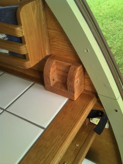

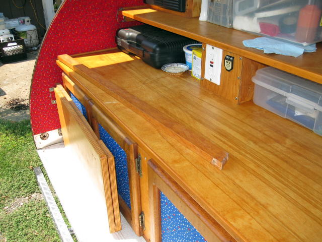

The receivers sit on the counter and 2 #6 screws attach it to the wall. This pic shows the receiver in place before being screwed to the wall.

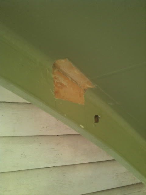

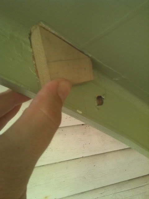

I then used a scrap piece of solid maple 1x2 for the uprights. I cut the angle at the top end to match the curve of the hatch, cut to the length that I wanted, then took a small portion off the top to attach to the hatch. This small piece is the only permanent addition to make this design work and it would be hardly noticeable if we decided to not use it in the future. I removed the paint and primer at the point of contact and glued it to the spar so all the pressure of contact would not be on the 1/4" hatch skin.

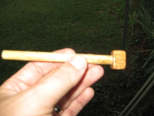

Then I painted the uprights and finished the receivers and pins to match the rest of the galley and attached the uprights to the top support with a simple hinge.

One quick question. Why did you angle the pins? To maybe make it easier to get you fingers around them?

I angled the pins downward so that they stay in place.

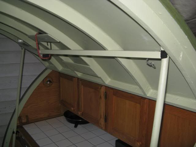

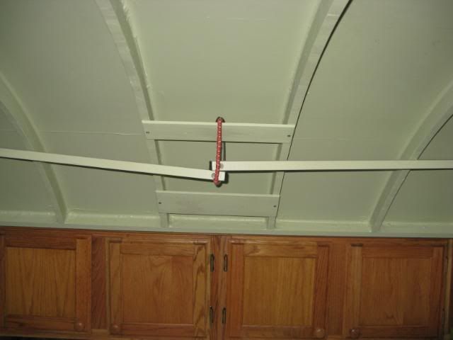

Here are 2 pics of the uprights folded in with a temporary bungee holding them:
BillZ

To me it seems what is making this difficult is the supports over lapping. If they lay flat and don't overlap it would make it easier to add latches and or magnets
Options so far
* shorten the supports. Of course that lowers the hatch.
* Shorten, advantages above, and move up the brackets.
* Shorten and move them closer to the front of the trailer but that would add stress to the hinge.
* kind half lap them so the lay flat.
* change the design so that hinged part at the top is angled just a little bit in opposite directions, this way the supports will miss each other and allow them to lay flatter so you can you a separate catch for each one.
* get shorter so the hatch can be lower and use suggestion one. :D

Postby CliffinGA » Mon Aug 22, 2011 7:25 pm
Options so far
* shorten the supports so they lay flatter and don't overlap which would make it easier to add latches and or magnets. Of course that lowers the hatch.
Or you can put the catches/magnets on the 2 second spars in where the pieces nearly touch the supports.

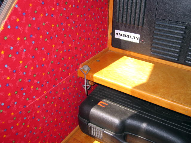

Postby Nobody » Tue Aug 23, 2011 2:32 pm
Nice retro-fit Bill! :thumbsup: I wuz thinkin' of something similar during my initial build but never figured out the 'hold-up' mechanism so I just went in the opposite direction & hinged my props at the counter & let 'em lie flat on the counter during travel. I devised a latch/receptacle on the hatch made of aluminum & use a 'Linch Pin' as a 'keeper' to hold the props up & prevent a strong wind from lifting the hatch off 'em. Instead of trying to 'tether' the pins I just drilled a 'slanted' hole at each end of the counter to hold pins when not being used. My hinge pins have enough slack that the props are able to lie flat adjacent to each other when the hatch is down & they've never scratched or damaged the counter finish. My hatch is fairly heavy but my tiny wife is able to lift it (with both hands) & hold it up with one hand while raising the prop to its receptacle, then raise the other prop. Only problem she has is sometimes if the TD is parked on a downward slope to the rear, she ain't tall enough to hold the hatch high enough for the props to fit :o
We've since changed the galley decor -
Harvey -
