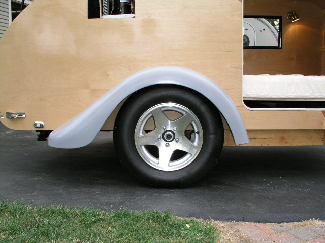

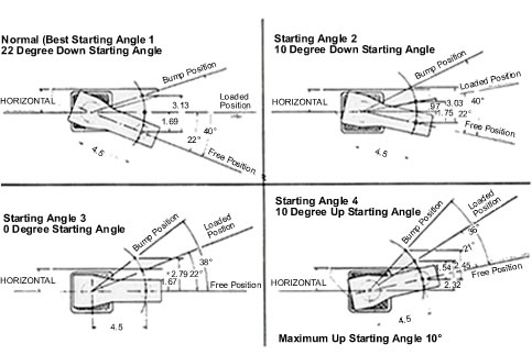

Gern Blanston wrote:My project is in the early stages, and I won't do any serious off-roading. I'm planning to use a torsion axle & 15" wheels. I'm really interested in your thoughts for an ideal height recommendation for this little trailer.
I'm wondering what ground clearances are being used out there? What would you consider a maximum/minimum/average ground clearance design?
