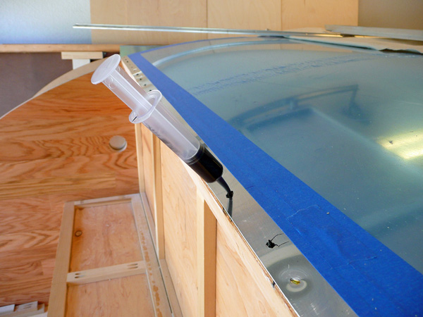

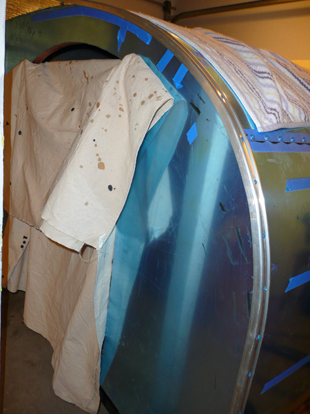

Postby aggie79 » Fri Dec 16, 2011 11:57 am
Robbie,
Although I epoxied prior to applying aluminum, in hindsight I think any protective coating on the plywood should be sufficient. In my opinion, the real challenge in using aluminum over wood is how to seal possible water infiltration at fasteners, seams, and around the trim.
I used a sealant around the perimeter of the aluminum sheets and at seams.
Then, I removed the temporary fasteners, "injected" sealant using syringes, and then installed the permanent fasteners.
For trim, I fitted it and temporarily attached it to the profile. I then removed the trim and added a bead of sealant to the trim. The screw holes were filled with sealant and then the trim was permanently installed.
So far everything has remained watertight.
Take care,
Postby Robbie » Fri Dec 16, 2011 12:51 pm
Thanks for the pics Tom! What kind of sealant did you use there? I was planning on doing my aluminum install pretty much the same way you did yours will sealant at all the perimeter edges and then overlapping the aluminum where the sheets will meet on the top. I was also thinking of applying the sides first and then putting on the roof skin and bending the edges of the roof skin over the top edge of the sides about a 1/4". But seeing as I have the front and rear bends in my profile I'm debating whether that would be worth the trouble.
I'm starting to consider just getting a smaller CPES kit and doing the CPES around everywhere there is a seam/edge of the aluminum and then 2 coats of primer/sealer over the entire thing. That way all the possible leak locations will have the epoxy but I don't think the CPES in the field is really necessary.

Postby Oldragbaggers » Fri Dec 16, 2011 1:18 pm
Beautiful job sealing it up Tom. You should be good to go for a long long time.

Postby aggie79 » Fri Dec 16, 2011 4:40 pm
Robbie wrote:What kind of sealant did you use there? I was planning on doing my aluminum install pretty much the same way you did yours will sealant at all the perimeter edges and then overlapping the aluminum where the sheets will meet on the top. I was also thinking of applying the sides first and then putting on the roof skin and bending the edges of the roof skin over the top edge of the sides about a 1/4". But seeing as I have the front and rear bends in my profile I'm debating whether that would be worth the trouble.
Robbie,
I used 3M 4200 marine sealant. It's good stuff but anything with "marine" and/or "3M" in the title means it is expensive - about $12 per tube.
Although the 3M 4200 is "removable" I didn't use it around my windows. I used the standard butyl tape so I could remove them in the future if needed. After squished out and then set for a few weeks, I trimmed the tape and followed up the edges with OSI gutter sealant that I got at the BORG.
The reason for the long-winded explanation above is that knowing how good the OSI worked - at about $4 per tube and available locally - I would use that instead of the 3M 4200 in the future.
