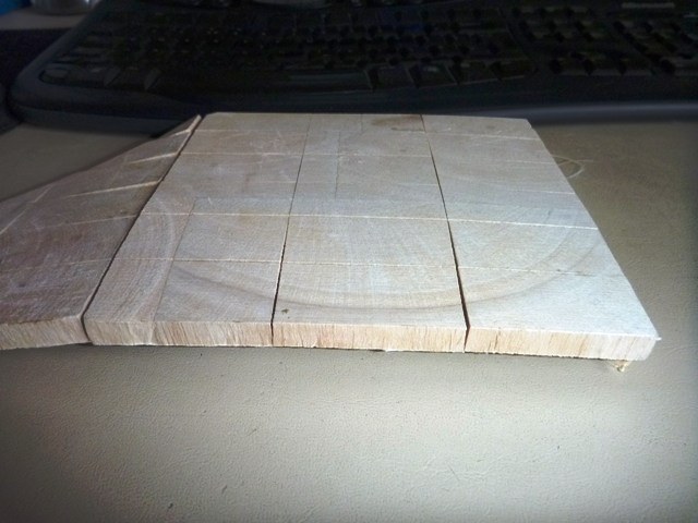

Postby angib » Sun Jan 01, 2012 7:22 am
Becky, balsa core is used in fiberglass to increase its strength without adding too much weight - but this is for decks and cabin roofs that you can walk on, so these are structures far stronger and heavier than any teardrop needs to be. Just the skin on one side of those decks is stronger than a teardrop needs to be.
All sandwich structures suffer from the problem that once you've made the outside skin tough enough to withstand minor impacts, like on a dirt road, it's tough enough to be all the skin the teardrop needs. I think Steve Wolverton used the best lightweight construction for a small trailer body:
- 4mm (3/16") plywood outer skin - preferably marine plywood;
- minimal 3/4" deep (ie, 1x...) framing;
- foam insulation between the framing, if required for heat control;
- fabric inner surface glued/stapled in place.
You can argue that 1/8" plywood is enough for the outer skin, but I think it is a bit fragile on its own.
Some folk might like to research balsa sandwiches as I think they haven't realised it is end-grain balsa that is being discussed - quite different from cross/side-grain balsa which would be fairly weak. Here is an offcut of 1/4" end-grain balsa (stuck to a scrim backing to make it a flexible sheet material until laminated in place):
