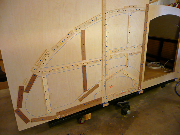

Postby aggie79 » Fri Jan 06, 2012 9:51 am
I used a product similar to Liquid Nails - PL Premium - to attach plywood skins to the plywood frame.
I applied a bead of the PL Premium along the perimeter of the profile, around openings, and along the "framing members". I also added some random beads across the insulation to the plywood framing. I then set the plywood skin on top and used a j-roller on the plywood skin to force the PL Premium to spread out. Then I used screws and scrap plywood as cauls to "clamp" the skin to the plywood.
This method does not result in the entire plywood framing surface area being bonded to the skin. It is however, have substantially more than enough structural strength.

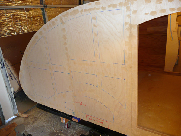

Postby aggie79 » Fri Jan 06, 2012 1:35 pm
Steve,
Titebond III is a good product. I it used to bond the skins of my insulated floor. The only issue I had with it is I worked by myself and couldn't work fast enough for its comparatively short open work time.
As I now realize, most of us first timers incredibly overbuild our teardrops. In the picture below, my teardrop shell is only supported in three places - once at the middle of the floor at the front and twice at the rear sidewalls. My wife and I sat in the shell - we're about 330 pounds total and I'm about 2/3 of that - and there was minimal deflection even without the exterior plywood skin on.
When I glued the exterior sidewall skins on, I just ran a bead along the framing and not on the insulation. The picture below shows the plywood scraps and self-drilling screws that I used to "clamp" the outer skin.
This is what it looked like after the screws removed, excess plywood cut away (routed), and with screw holes filled.
Take care,
