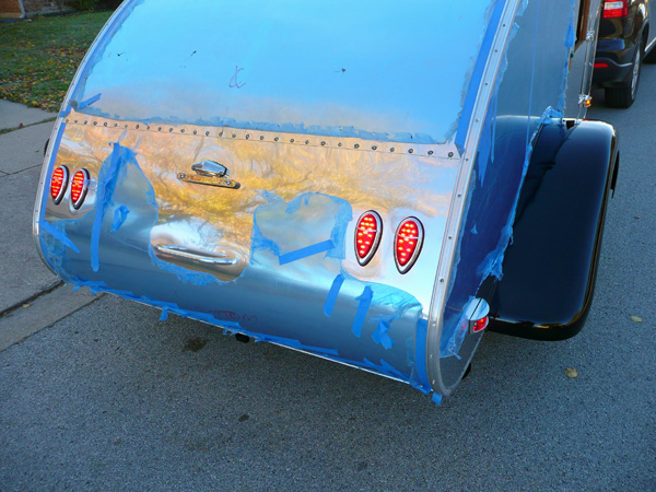

Postby halfdome, Danny » Wed Feb 15, 2012 9:40 pm
You might look up Doug Hodder's Rocketeer in the Hall Of Fame.
He did some riveting either in acorn nuts or paint.
Here's a picture of it.
You could also use pan head stainless steel screws evenly spaced.
Square drive would give the best effect.:D Danny

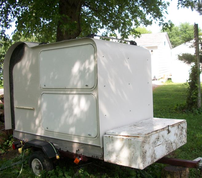

Postby aggie79 » Thu Feb 16, 2012 1:17 pm
I don't have a good picture of it, but I used the stainless steel, square-drive, washer pan head screws Danny mentioned.
In addition to aesthetics, the screws are located where I had to overlap my aluminum sheets.
