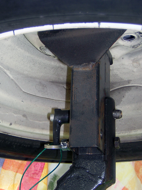

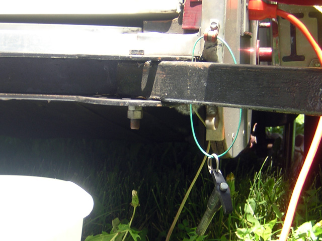

Postby s4son » Tue Sep 13, 2005 10:35 pm
Here are the pictures I took in Minden.
This pic shows how the spare is mounted to the rear of the trailer. Pulling a pin allows the mount to swing away to the side.
This pic shows the hinge from the side.
This pic shows the tire mount and swivel. In this picture the "table" is in the up position.
It looks like the carrier was built similar to Shrug's design with a piece going up at a 45 degree angle.
Scott F.

Postby Gage » Wed Sep 14, 2005 1:03 am
I followed Margie for several hundred miles going to Minden and her spare tire doesn't bonce. She has to swing it to the side so as to open her hatch. Then after the hatch is open, she positions it where she wants and pins it in place. So simple.
Look at the first pic (that Scott posted) closely and you'll see another reason why it doesn't bonce.

Postby Larwyn » Wed Sep 14, 2005 4:15 am
s4son wrote:Here are the pictures I took in Minden.
Scott F.
From what I see in this picture is that the way that hinge is designed, it provides support for several inches to a portion of the bracket that runs parallel to the ground and the back of the trailer before the 45 degree angle. This portion of the bracket seems to be confined from moving in all but one direction by the channel and of course the pin locks it into the channel when in the travel position. This takes most, if not all of the strain off the hinge pin and eliminates a good portion of the leverage from hinge to tire. It appears to have even more support than my suggestion of a center bracket.
