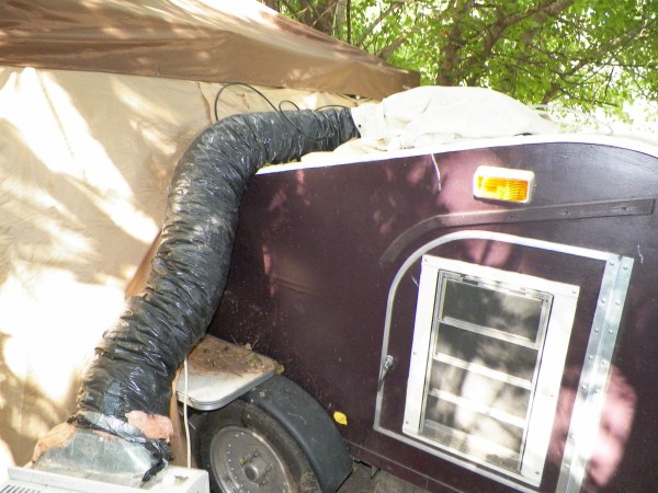

We just took a regular window air unit(long as you have access to power) screwed floor duct boot to the front where the air comes out and took a flexible duct from there to the roof vent.Works great as long as you have some place to store it while you travel. The unit sits outside the teardrop so noise isn't a factor.

You can get 6" insulated round duct at a heating & cooling distributer. We just have a 5000 sitting outside with the duct stuck under the roof vent with a drop cloth over it to seal it up and works great.That way all doors are operate.Like sleeping in a refrigerator(great)

Have any pictures of this set up? I'm having a hard time picturing a 6" duct and a normal window unit meeting together.

Postby JJKC » Tue Jul 24, 2012 6:30 pm
td1 (600 x 450).jpg (64.81 KiB) Viewed 1993 times
td2 (600 x 450).jpg (77.02 KiB) Viewed 1993 times
