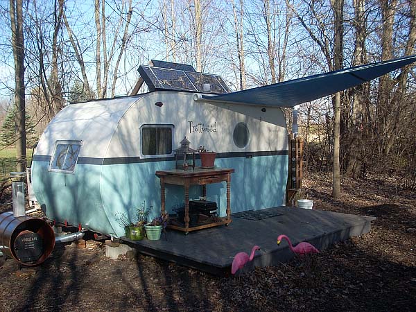

Shadow Catcher wrote:High temperature water pumps used for small solar heat applications are available and with the right set up you might be able to get it to siphon with out a pump. One problem with automotive radiators/heat exchangers is that aluminum fins which are great for transferring heat would be vulnerable to high temps and tight spacing would mean it would clog with ash. I used a B&M transmission oil cooler on our TV and the rather robust nature would lend itself to a simple 'boiler', my thinking is that the wall thickness is fairly robust on the tubes and there is enough spacing that it is not likely to clog with ash. Using a computer case fan through a heater core should work fine.
This is the B&M oil cooler![]()
Using high temp hose with quick disconnects and a fold-able support for the oil cooler I do not see where this would be bulky or particularly heavy. There are a lot of ways you can go with this and I do not see water hoses as more of a tripping hazard that electrical cords...
mikeschn wrote:![]()
droid_ca wrote:
Mike how big is that TV??
