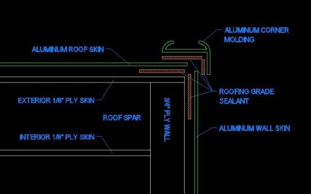

Postby Robbie » Mon Mar 04, 2013 5:57 pm
Here's a quick exaggerated drawing of how all the skin/sealant layers overlap... Hope this helps. :D

Postby Irving » Mon Mar 04, 2013 6:36 pm
Excellent. Your advice is most helpful. Where have others found their aluminum? Anywhere to order a large roll online that you have found? How much did you spend on it? I initially was looking at ordering large sheets of it from discountsteel.com and then realized that shipping was too cost prohibitive..
Also, what material works well at the corners and seams that overlaps the aluminum?
