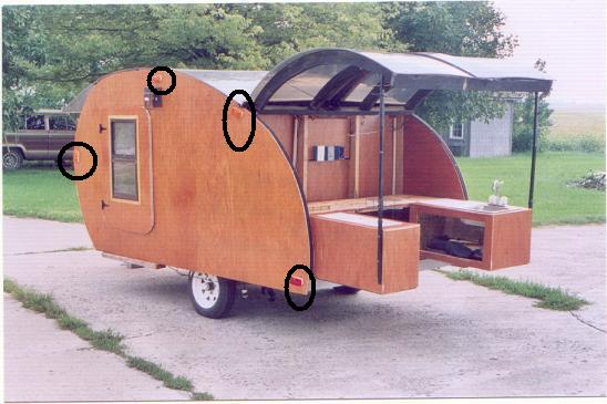

How many and at what locations do you have marker lights on your build? What size is your trailer? Orange or red marker lights? Using any reflectors rather than lights?
My travel trailer is 6 feet x 10 feet and 6 feet high. Right now I have 2 orange led lights for the lower front sides, 2 red led lights for the upper back sides and tail lights that also have lights on their sides. I have 4 orange reflectors that I plan to attach around the top. I also plan to use a third brake light.
I sometimes see trailers with a LOT of lights all over them. I wonder if I'm doing enough.

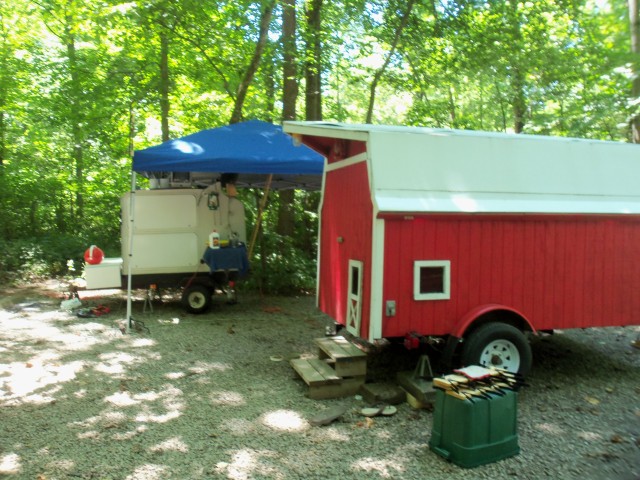

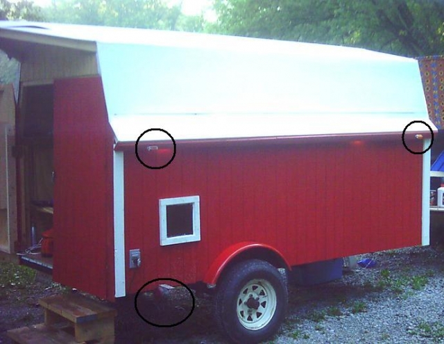

Chubby has 3 amber and a red clearance on each side. I had a set of led tails installed under the lexan skin in the rear but decided I needed to add surface mounted rear tails and about 6 tiny reflectors at the bottom of the gally hatch help to get the tiny trailer noticed
The barn has a amber front and a red rear.
I left the stock tails but continued to worry about someone behind with their head up their butt not noticing them because they were so low so I added a 3rd brake light. It is mounted in the red lantern above the rear doors.

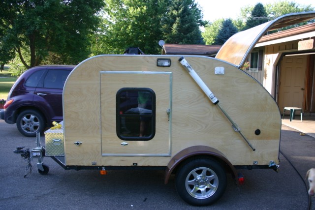

I have the standard lights that come with the trailer. More would have been nicer but I built on a budget.

TPMcGinty wrote:I have the standard lights that come with the trailer. More would have been nicer but I built on a budget.
Technically your marker (clearance) lamps are wrong.... They are not supposed to be mounted at frame level but at upper most section of trailer body.... The only reason the are on frame level with HF trailers is because at time of sale and to have legal lighting the frame is highest portion of trailer....
BUT I seriously double an enforcement officer will take issue with where they are mounted....
