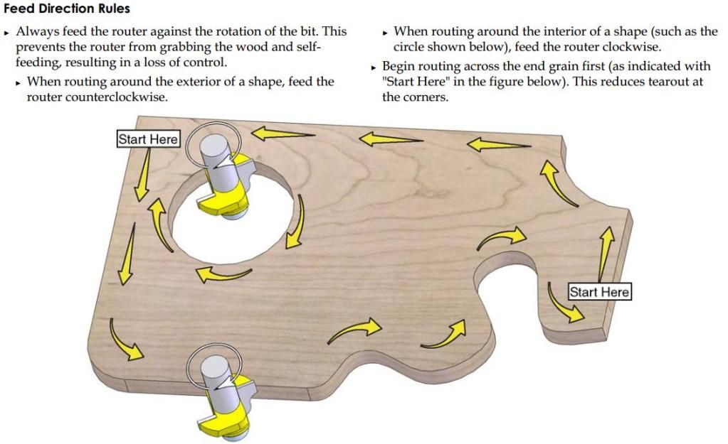

Strop wrote:Ok Dan, why counterclockwise?![]()
and what happens if you are in the Southern Hemisphere? Is it like the water in a toilet?
