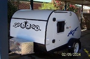

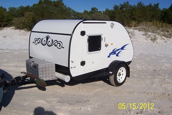

Postby Roo Dog » Fri Sep 20, 2013 1:20 pm
Kyle,
Our doors are a lamination of ply, aluminum and steel sheet on the outside with caravan wind out windows.
The ply is the plug in the hole. It is the section that was cut out for the door hole.
The ally and steel lamination's overlap the hole.
The whole TD is steel clad over the ply.
RD

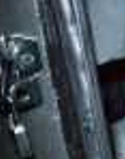

Postby kmagill » Fri Sep 20, 2013 4:16 pm
Many thanks for all the input. The ply probably is, in fact, 5/8". It measured as a little wider than that so thought maybe 9/16. Anyway, I roughed in the door with 2 Tee hinges and a latch and I can see immediately that I need to beef up the structure. I'll frame the door from the inside. I am planning on covering the roof with aluminum. I'm undecided on the walls. The were already finished with a waterproof seal when I got the trailer and I like the pairing of wood finish and aluminum. I may clad the door in aluminum for added structure and as an accent. Inching forward....
Thanks again.

Postby KCStudly » Fri Sep 20, 2013 6:29 pm
Here's something else to consider, on my doors, which are pretty large by TD std.'s, I have the door latch as near to the middle as the window will allow (without crowding it or putting the window awkwardly high), and I will fit the hinges as near to the top and bottom corner radii as is practical.
This creates a triangle between the hinges and latch with nearly equal parts of the door above and below the latch. Because the span between "support points" across the corners of the open side of the door are as short as practical, there will be less flex in the door panel when pulled tight against the seal. i.e. Imagine a line between the top hinge and the latch, and another between the bottom hinge and latch; the farther the edges of the door are away from these lines, the more they can flex.
With your test fit, you have the top hinge well down from the top of the door, and your latch very near the bottom. I bet that your worst fit is currently near the top of the door opposite the hinges.

Postby kmagill » Fri Sep 20, 2013 7:53 pm
Thanks KC. Point taken on the strength of the triangle. My latch certainly is a bit low. It was an arbitrary position based on my imaginary window. The angle of the photo skews the apparent position of the hinges a little. They are both 5" off their respective corners. The door is 31" along that edge. The ply door isn't perfectly flat (it came, pre-cut, along with the rest of the trailer) and even if it was was, I can't imagine it would stay flat for long. If I was willing to part with the money I'd buy a pair of factory made aluminum doors but I can't do it. In the meantime I'm starting to wonder about a wood frame hollow door skinned with lauan and clad with aluminum on the outside. Too many possibilities.
