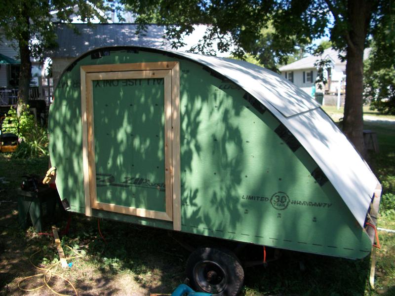

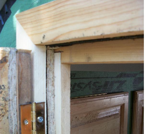

All of my builds have home built doors. After cutting the opening in the side I place trim inside as a door stop. I allow about 3/4 to 1" of this trim exposed to bump against the door blank. I add the same trim to the door with a 1" overhang on all but the hinged side, Any water will have to travel 2 1/2 inches in a serpentine route to invade the interior. To date no leaks have been detected and Chubby my first build has sat outside in all weather since 08. ( he just recently got a nice place out of the weather)
Here are a couple shots of my 4x7 tiny build's door construction.
NOW ! If I were made of money I would purchase the premade doors. I helped a good friend with his and the took about 20 minutes to install. Simply outline and jig saw out the opening and install the door. So simple a caveman can do it !

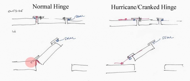

I'm making doors and wanted to put a frame on the outside of the door that sealed against the body.
Using a standard hinge this does not work as I found out to my dismay. You need a cranked/hurricane hinge with the pivot point further away from the opening
The diagram make it clearer...I hope this is going to work for me :thinking:
