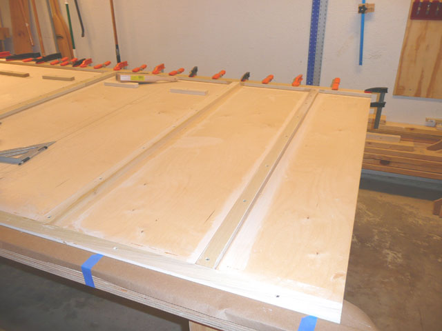

Postby aggie79 » Sat Nov 23, 2013 10:16 am
I used 1x2s to frame the floor. At the ends 1x3s. For plywood, I used 1/4" top and bottom. This assembly is plenty strong. 1/8" plywood probably would have been sufficient.
This is a picture of the framing being glued to the bottom plywood deck.

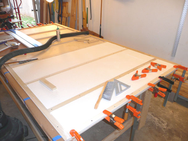

This shows the insulation being installed.

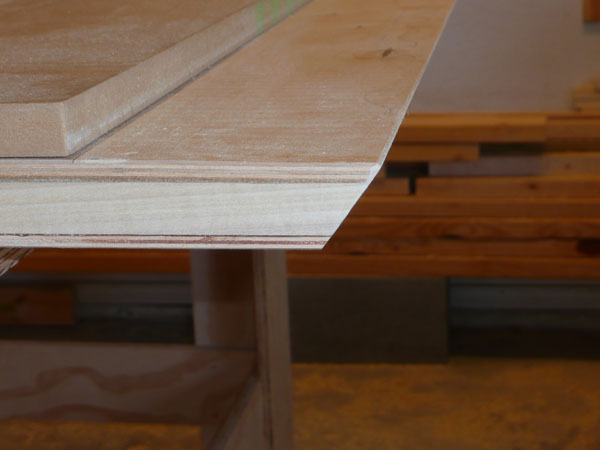

This is a section of the finished floor. I built the floor "long" and then trimmed it to length. The MDF board on top is a guide for my skill saw that I used to cut the angle to match the front curve of my profile.
