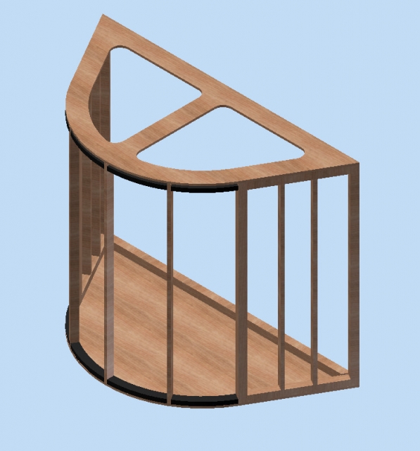

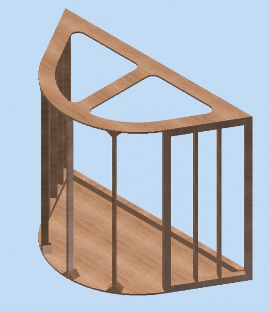

The short story. I’ve spent a bit of time trying to come up with a Tiny Trailer to tow behind a Holden (Chevy) Cruze, which fits in the Garage, takes a queen size mattress (and doesn’t feel claustrophobic), will be “reasonably” aerodynamic at 100 Km/h (62 MPH) and has enough Galley & storage space. So far I’ve got it down to possible 290 Kg (640 lbs) with a hefty trailer frame that is still under thought and development. LOL, I may be reaching here considering the tow vehicle specs, but design & research time costs little (I can dream). 8)

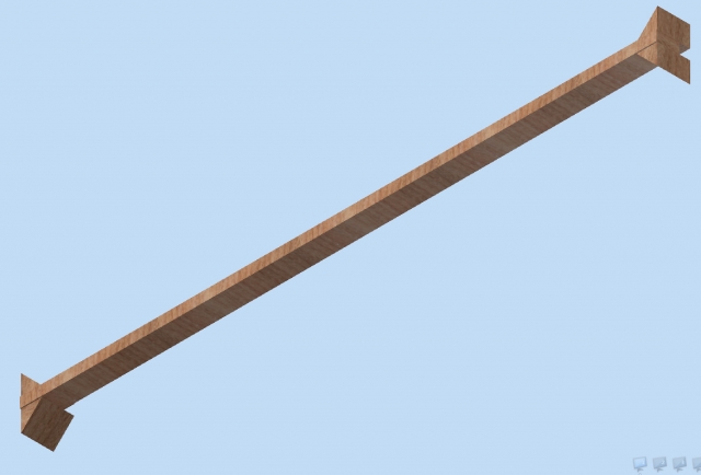

My question relates to a vertical support on the V nose radius that is 19 x 42 x 1176 lg (roughly 1 x 2 timber from what I can understand from US timber sizing). I’d like to use (and rely on) Polyurethane adhesives to avoid possible water damage issues from using nails/ screws etc. Gluing the end grain of the timber doesn’t seem wise due to the 1.2 square Inch profile. But adding the mounting blocks increases that to about 5.5 square inches for the connection on the vertical member, and 7.8 square inches for the mounting block connection to the ½ inch plywood floor on that section.
LOL…..am I over engineering (and over thinking) things, or does this seem reasonable to all of you who have actually built one of these little escape machines? :thinking:
Cheers! :beer:

How thick is the plywood over and under the posts? I wonder if you could substitute Kregg pocket screws for the corner blocks.
Regardless, I think you should consider adding base and cap rails to (or spacers between) the posts similar to the non-curved wall frames of the vee. That way your skins have support around their full perimeter, otherwise you could pop the skin away at the base of the wall pretty easily when stowing cargo, etc.
You don't want to screw or nail the outer skin into the edge of the floor and ceiling ply anyway, so the extra blocking or base/cap rails will be needed. And since you will have to fasten the skin, at least temporarily while the glue dries, there are going to be plenty of holes to seal anyway, so a few more screw heads from the outside won't make that big of difference, IMO.

I agree with KCSTUDLEY, install blocking between the nose ribs top and bottom. That gives extra area for glue to lock in the ribs and gives an all around surface to attach the inside and outside skin. Your V nose front construction (yours is horizontal) should be very similar to a standard tear front curve (standard would be vertical).
With the blocking glued and screwed between ribs, I would just put one screw through the floor and roof into each nose rib and glue. In fact, that is how I did my standard tear ribs. Plenty strong.
Also, you must consider that the curved sandwich construction shape will add tremendous strength too.
Also thought I would mention that your tire and axel appears dead center in the trailer. As tears have a heavier galley, the Alexa should be 1/3 of the way in from the back as a rough guess. There is a guide and calculator on this site to find the ideal axel location, but after you go through the effort, it will end up... ...about 1/3 up from the back.

The floor in the nose section is intended to be 12mm marine ply, as is the skeletonised top frame. If I laminate two 12mm ply profiles together to form the cap rails, that’ll give me just under an inch and a half overall mating surface for the ¼ inch ply skin and glue. Sound about right?
I’ll have to check out a supplier for the Kreg gear in Aus.

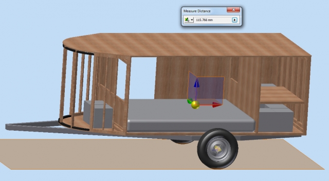

City…..yup, the axle is almost centre to the cab at the moment. LOL….an unfortunate (sort of) circumstance of the V form nose. I ran the centre of gravity with 40 L of water, plus a portable fridge/freezer and an extra 25 Kg of sundries in the galley. Allowed for another 40 Kg of various items (battery plus sundries) in the nose storage, and that’s where it put me (roughly). The trailer frame is one of the next things I have to tweak for its configuration and layout, after I have the cab nutted out. Before it hits the shop floor I’ll adjust it for a suitable hitch weight.

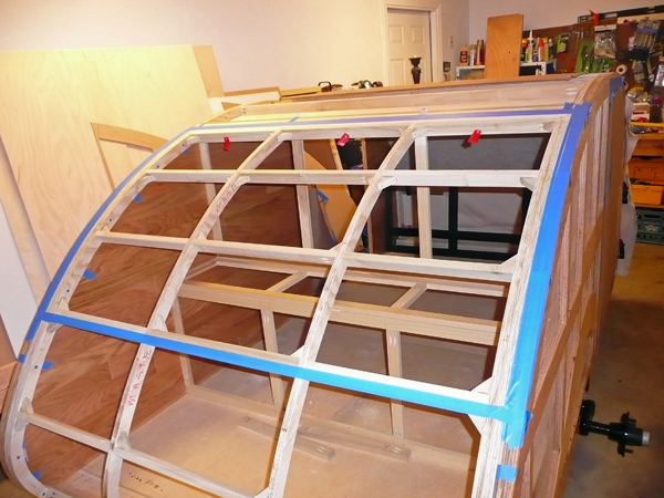

The pictures below show my hatch construction. The parallel "ribs" or spars are plywood. The transverse framing is poplar. (I used Kreg pocket screws to fasten the poplar to the plywood ribs and then later added corner blocking to help hold the framing square while it was being skinned.) I used PL Premium construction adhesive to glue the 3mm plywood skin to the hatch framing. Screws (fastened through the end-grain plywood ribs) were used to hold hold the plywood skin in place until the adhesive set and then they were removed.
Regarding the Kreg or pocket screws, I have a Kreg tool and used it frequently in my build, but I think an easier and stronger method of fastening your vertical framing in the front is to fasten the framing top and bottom through the deck and roof plywood.
