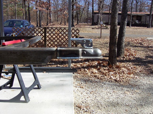

Postby stjohn » Wed Jan 11, 2006 1:48 pm
3 ft will let it almost jacknife behind my f150 ford or do I want it to be able to jacknife all the way.below is a pic of the boxed hitch I finshed this morning
