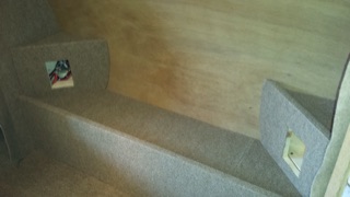

Postby bobhenry » Mon Apr 18, 2016 9:30 am
I used some heavy weave fabric almost burlap but softer. I cut blue foam to press fit the walls and wrapped the fabric over the foam and back taped it. Eazy peazy no nails screws or glue has worked well for 5+ years.
Here s the trimmed out window described above

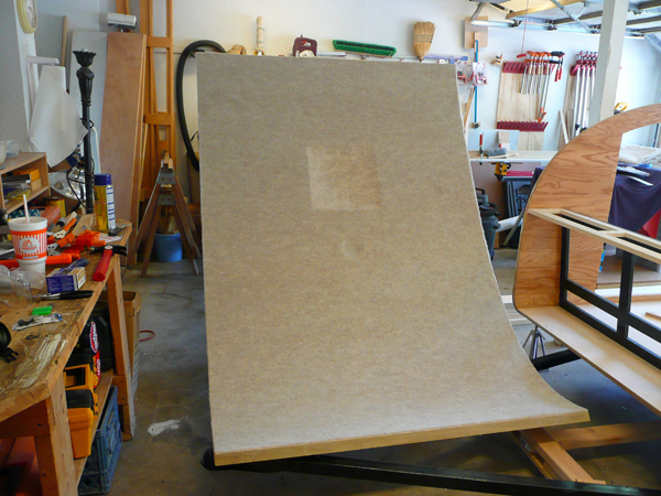

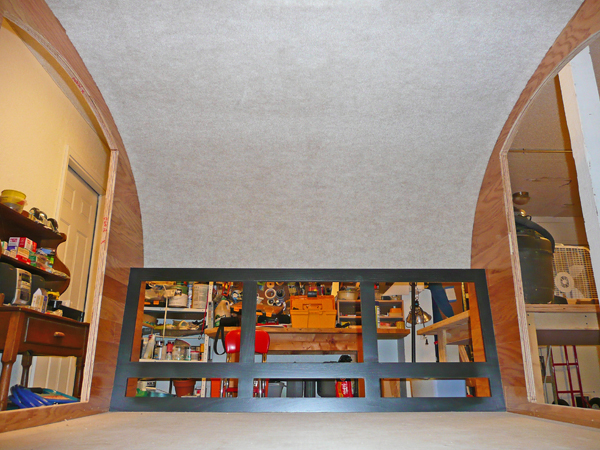

Postby noseoil » Thu Apr 21, 2016 7:36 am
We used raw canvas (unbleached) for our headliner. Contact cement & did the same type of installation with the canvas applied first, then dropped the headliner.
If I was doing the walls & ceiling both, I would work all the panels on a bench first & upholster them laying down, then assemble the finished panels with a bit of help from a friend to stand them up.
Sequencing is very important to think through, first. Don't forget wiring, lights, cabinet attachments, etc. prior to skinning things and standing the walls!
