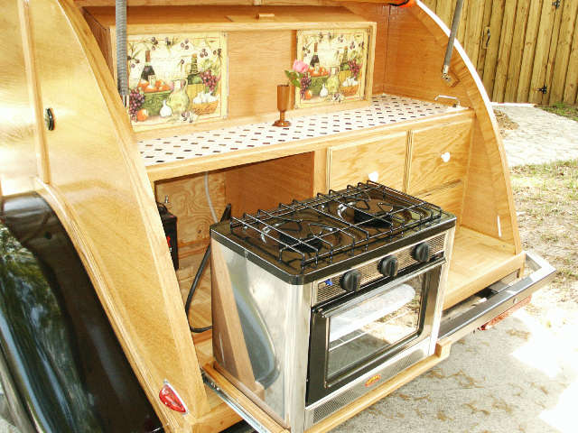

If you want a "real" stove with an oven check out my photo

mexican tear wrote:If you want a "real" stove with an oven check out my photo
kai
Kai,
Yup, gotta agree with you :thumbsup:
Steve
Steve_Cox
Posts: 4903
Images: 196
Postby Chris C » Mon Jul 03, 2006 12:02 pm
I agree also! :thumbsup: Already cooked a bunch of meals on and in it and concure it is a super item to have in your teardrop. :applause:

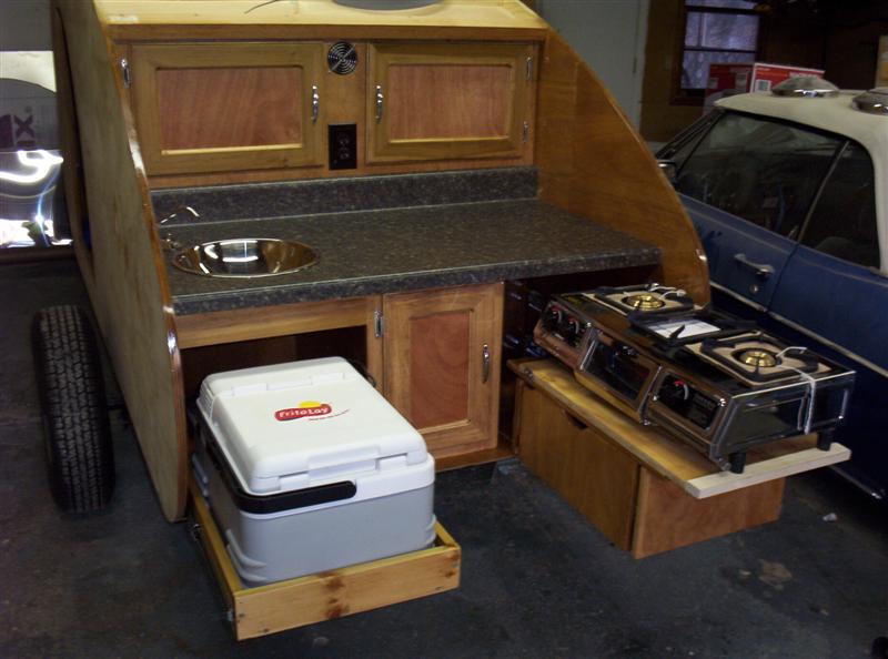

Postby Sonetpro » Mon Jul 03, 2006 2:17 pm
Heres how I did it. It's a double slider. The cabinet is on a full extention and the shelf it sits on is also on a slider to move it away from the countertop.
