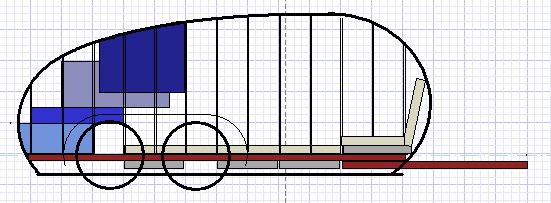

As promised to Madjack and Bledsoe, a picture, notice its traditional shape, there won’t be a microwave, no radio antenna, there might be some extra storage and I sure won’t be complaining about the short bed, you see, I’m on the taller side too. I might even put a heater in it, out here in Oregon, we really don’t need air-conditioners, we don’t have the humidity like people on the East coast and the great lakes area. (Hey, I'm just yanking chains, I'm really not a bad person) :)
Well forum viewers, what do you think? Did I stretch the limits too much?
