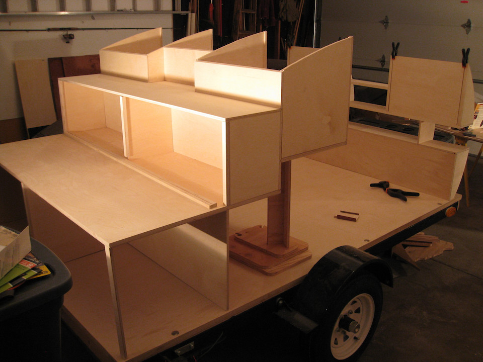

I just did 1/2" baltic birch construction with 4/4 alder face frames. They were designed to provide torsional stability in the "box" at the front & back. I used a 1/4" panel for the galley/footboard cabinet backing which was slotted into the walls, floor & hatch spar. It's heavier than necessary, but there is no flex in the build & the cabinets are now a structural element. If I did it again, I would most likely shave some weight by doing more of a frame & panel design like Woodbutcher's.
I would still have a sandwich-wall build with insulation. It's just too hot here in the desert to not consider some insulation & cooling for summer camping.

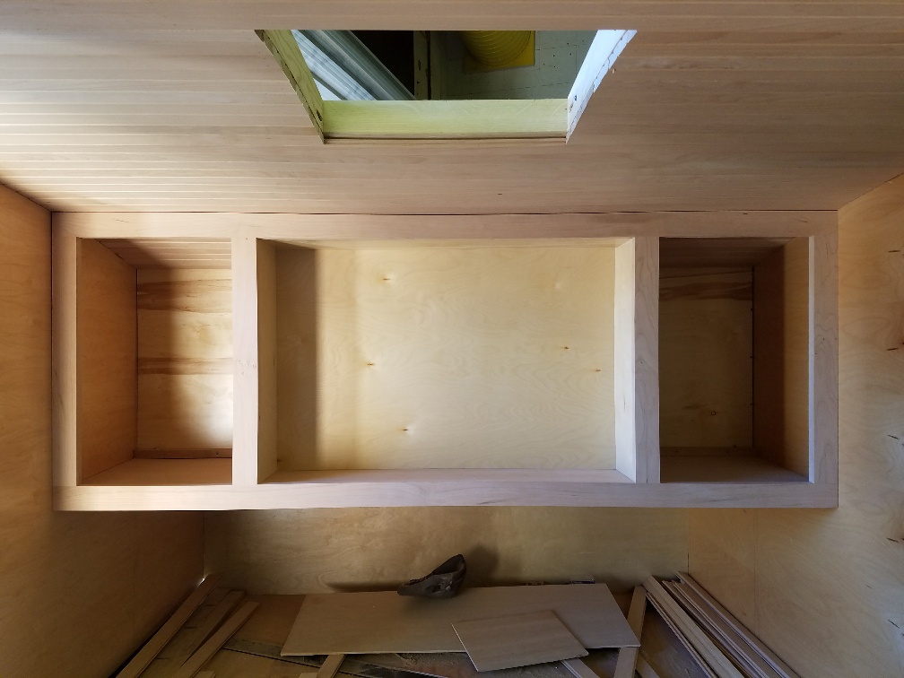

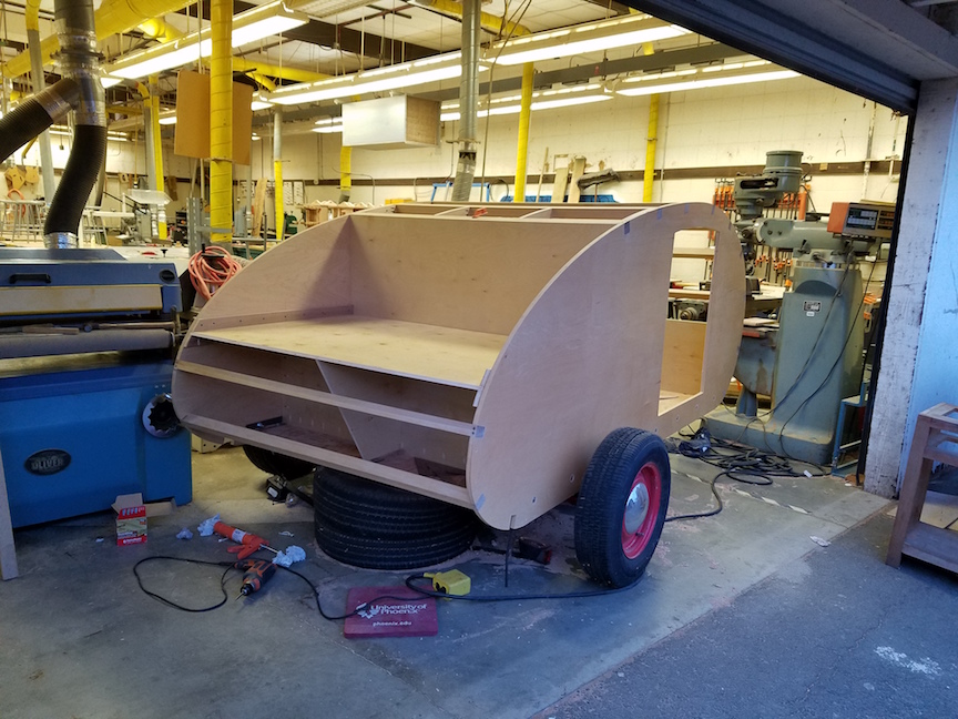

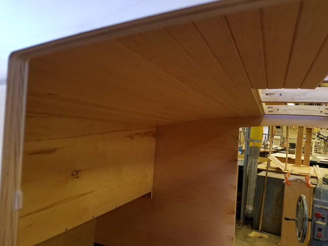

Postby jgerqano » Tue Feb 28, 2017 6:49 pm
Thanks for all the tips guys.... Here is a pic of the project.. As soon as I get the tongue and groove roofing on the cabinets are going in...

Postby jgerqano » Mon Mar 06, 2017 8:38 pm
Face frame and bottom only with the middle cubby reserved for a tv. Yes I know most of you like to be outside when camping, but I love watching an hour of tv right before I fall asleep.
