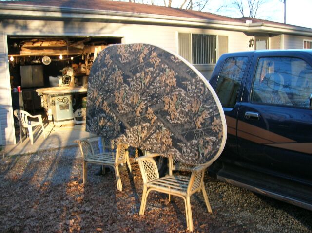

Postby Jim Marshall » Wed Feb 01, 2006 8:46 am
Mike, here is a pic of our side profile. The front is like a Benroy but the back is more like the modernaire. This is with the inside camo finish already applied. Our tear will be a 5 X 8.

Postby mikeschn » Wed Feb 01, 2006 9:55 am
Jim Marshall wrote:Mike, here is a pic of our side profile. The front is like a Benroy but the back is more like the modernaire. This is with the inside camo finish already applied. Our tear will be a 5 X 8.
Jim,
Can you take a side view of that picture so I can trace it?
P.S. Shouldn't the camo be on the outside?
