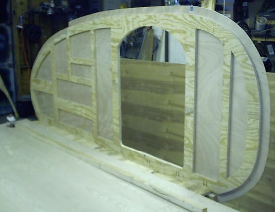

Postby Nitetimes » Thu Feb 02, 2006 6:11 pm
EZ wrote:I still would like to try 1/4" Luan for the outside material, but how would you connect the stringers? I thought about notching out the foam/paneling, sort of like a dado (if that's the right term) but then there would be very little surface area to glue on the top unless you count the foam and the paneling. Not much to screw the top to while the glue dries.
EZ
The simplest thing to do is like in this pic,
Make your upper frame the thickness of your spars + the thickness of your ceiling material shorter than your sides. Then after you assemble your walls you can stand them up and attach them, then lay the ceiling on the lip created by the frame. Then you just lay your spars on top and screw them down to the framework. It's real simple and easy to do.
Hope this made sense.

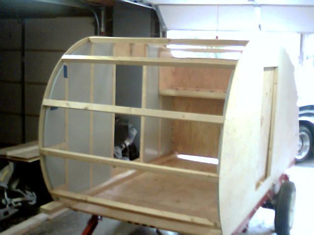

Postby Hardin Valley Magic » Thu Feb 02, 2006 8:29 pm
EZ here is a pic of the way I did it. I used 1/4" luan for the outside and attached studs to it with 1 5/8' screws and let them short so the spars would rest on them. Then ran 3" screws through the spars and into the top of the studs. However after completing the inside framing I covered the luan with 3/8" bead board. It was covered with titebond and shot on with 1" staples.
Sorry for the long reply. Check my gallery for more pics.

Postby Nitetimes » Thu Feb 02, 2006 11:07 pm
Any of the above will work, I basically did the same thing as Steve did only with ply instead of sticks. The advantage to the way we did it is you have a lip to lay your ceiling on and you just sit your spars on top. Any way that works for you is gonna work. Luan is fine for the outside skin provided it is well waterproofed. Mine is 1/4" - 3/4" - 1/4" and it is plenty strong. Build it the way you want it and impress yourself with your ingenuity no one else.

Postby bledsoe3 » Fri Feb 03, 2006 12:02 am
EZ, Here's a picture of mine. I removed all of the screws after the glue dried. Then I glued the inner skin on and trimmed with a router.
The bottom 1X4 sit on top of the floor and the remainder covers the side rail.
Here is the wall installed with the inner skin in place.
