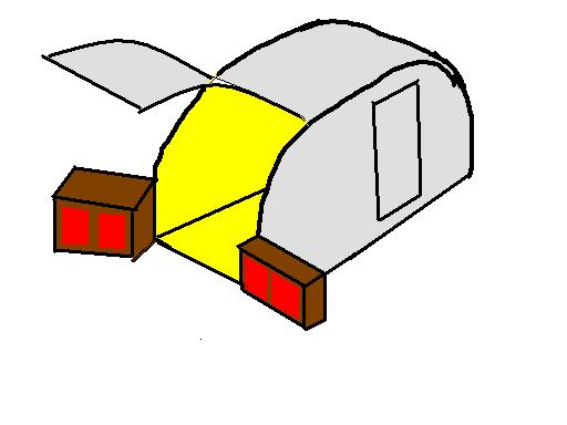

Postby MikeDrz » Mon Feb 06, 2006 8:07 pm
funny you should mention that. I was just driving behind a Chevy astro van that had a 3 door hatch setup. top 1/2 swung up as normal, bottom 1/2 was a pair of mini barn doors, which swing out to the side.
my thought was mount the bottom cabs so they swing out with those doors
something like this....
critter wrote:hey all,
you could just put a hinge on the galley and swing it out of the way or up or down and use it for a ramp :thumbsup:
[/url]

Postby Nitetimes » Tue Feb 07, 2006 12:48 am
toypusher wrote:Image
Why not do something like this, where you keep the bottom cabinets just far enough apart to clear the pedals, then use two narrow cabinets towards the outside to give you room for the width of the handle bars. You could do the hinged counter top like Kerry shows and even hinge a couple of doors too close the space between the cabinets.
Just a thought here, but what if you turned the rear bars sideways and backed it in, remove the front wheel and build some sort of prop for the forks to lock into between the lower cabinets. Then the top cabinets could be bigger or the same size as the bottom.
Hope some of this made sense.
