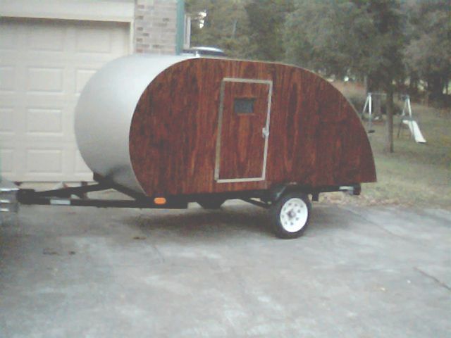

Postby Steve_Cox » Sat Feb 11, 2006 8:00 pm
Jim,
Most that buy doors say they bought because of time constraints. I would think the 1st step, that you didn't mention here but might have in other posts is what type of TD are you going to build. Pre-made doors don't lend themselves to all types of teardrops but all teardrops lend themselves to build them yourself doors.
I think the doors I built are a little different, heck, most of the stuff I build is different. My doors have a exterior frame, and two 1/4" sheets of oak plywood, this was all epoxied and clamped together, no screw, dowels, biscuits, or mitered cuts. I over sized the plywood parts and trimmed them with the router.... took all of an hour to make a door not counting the time for the epoxy to cure. They were easy. Hardest part was cutting boards close to the same length. But this wouldn't hardly be suitable for an aluminum sided tear... would have had to put the frame pieces in the middle. But, there are many ways to build a door.
Steve 8)
Steve
Steve_Cox
Posts: 4903
Images: 196
Postby JunkMan » Sat Feb 11, 2006 8:28 pm
Great looking door Steve :thumbsup:

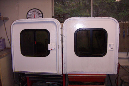

Postby Gaston » Sat Feb 11, 2006 9:42 pm
the doors I found are surplus RV "bunk bed" doors. They are 1" thick ,prehinged in 2" thick surface mount frames with windows, weatherstripping and keyed latches. Cut a hole, lay down a bead of sealer, drop in the door and screw it to the side wall. I'm doing it this way cause the doors cost me less than a hinge, window, and latch . ($75.00 each) :thumbsup:
The difficult we do now... the impossible takes a little longer
Gaston
Posts: 493
Images: 98
Joined: Mon Sep 19, 2005 7:06 pm
Location: Oregon, Gaston
Postby Hardin Valley Magic » Sat Feb 11, 2006 9:49 pm
Gaston, sounds like a deal!! :thumbsup: What are the over all deminsion?
aka Steven D.
Hardin Valley Magic
Posts: 548
Joined: Wed Sep 14, 2005 9:45 pm
Location: Knoxville Tenn.
Postby Gaston » Sat Feb 11, 2006 10:06 pm
Steve
the doors are 36" tall by 30" wide outside the frames and the frames are 2" thick but can be fit in a thiner wall they would just stick into the cabin
The company I got them from buys surplus and damaged mobile home and RV stuff. The doors like I got are pretty rare but can be made by shorting rv doors and moving the hinge
