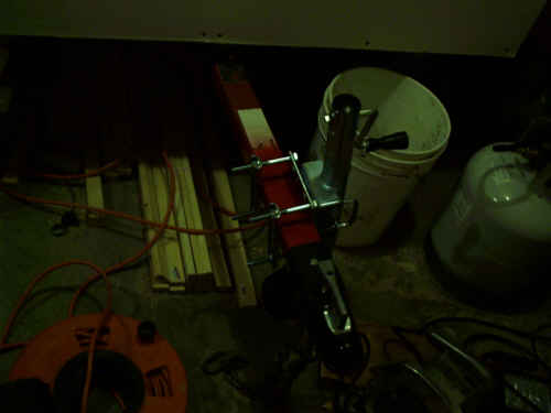

Postby Gage » Wed Mar 01, 2006 11:26 pm
Spadinator wrote:Well.....the weight of the trailer caused the tongue to twist!!! :x
<snip pic>
New tongue material.....$40.00 for 8 ft!!!
How does the weight of the trailer cause the tongue to twist? It must be the jack. The side mounted jack is not recommended for this type of installation because the jack is not on center line. Think about it.
Most likely part of the reason I don't have this problem is because I have a 'A' frame type tongue and my frame is not a store bought bolt together frame. Another reason the HF type frame is not recommended by a few of us. (Boy, I bet that will cause an uproar).

Postby Spadinator » Thu Mar 02, 2006 10:13 am
Your absolutely right Gage.........When I bought this trailer 10 years ago from Fred Meyer Harbor Freight was not even heard of in our area. The jack that was meant for this trailer is no longer available. I wished it was an A frame tounge but oh well-

Postby Gage » Thu Mar 02, 2006 10:40 pm
Spadinator wrote:That is exactly why I am going with an 8' piece. The original tounge is 5 1/2 ft in length. It will allow me to connect to a cross member further back on the trailer as well as extend the tounge!!
:D
It will still want to twist on you with the jack. Being how your going to redo your tongue, you might want to add a piece of angle to each side attached as far forward as you can and then to the existing 'A' frame as close to the cross member as you can. That should prevent any twist attempt cause by the jack when in use. Just a suggestion.

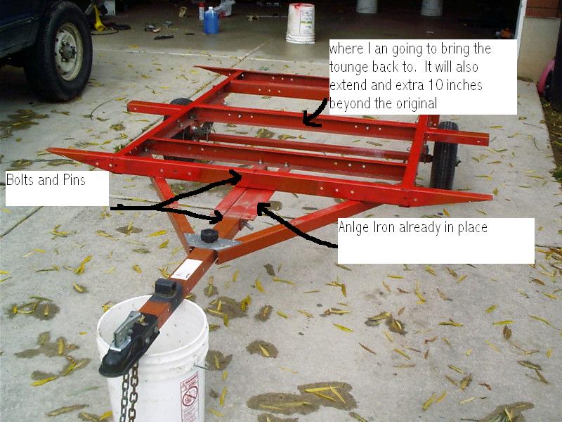

Postby Spadinator » Thu Mar 02, 2006 10:53 pm
The Angel Iron is already part of the trailer.......here is an explanation
The twist started after where the side braces met on the tongue.

Postby Gage » Fri Mar 03, 2006 12:39 am
Spadinator wrote:<snip>
Strange, I would think it would be just forward of where the braces meet the tongue. :thinking: How well are those side braces attached?
This is about what I was thinking.

Postby Spadinator » Fri Mar 03, 2006 9:17 am
Yeah I know....the twist started between the angle iron and the diagonal braces. I thought of extendeing the cross braces like you drew but the originals were already bolted on and I guess it comes down to me being a little lazy!!!!
