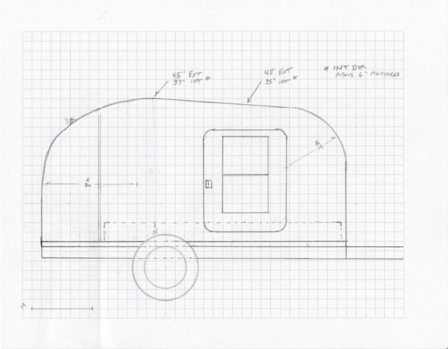

Wondering if anyone has done a Generic Benroy cabin with a feet forward design. I don't know how awkward that might be to enter and exit with the door in the traditional location. I'm not a big person and fortunately still have plenty of flexibility in my joints. My goal is reducing drag with the frontal area as much as possible. I'm open to aerodynamic lessons if this seems foolish.
Some details...
-The generic Benroy plan has a 19" radius on the top front corner. I've drawn a front wall profile with the high point of that 19" radius at 42" (as opposed to 48") to improve aerodynamics behind my tow vehicle which is 58.5" high. The 16.5" difference is the height of the trailer chassis above the road. Utilizing the full 48" of the sheet goods for the front wall profile would result in 8" sticking up above the tow vehicle roof. Just to be clear... though I love Slim's ingenuity I don't want to strap a snow board on the back of my car :lol:
-Continuing toward the back, the roof would slope up another 3" to just forward of the bulkhead location. Maximum exterior height would be 45". At the center of the door I would have headroom of 35" above the 6" mattress and be about 36" near the back of the mattress. I've found I need a minimum of 32" to be comfortable sitting. If I could find a firm 4" mattress I could lower the profile a little more
-To allow for sitting and reading I'm thinking of running the bulkhead straight up from the floor to the hatch hinge and eliminating the inside storage space (cabinets) over what is normally the foot of the bed. A less substantial storage area might be up front over my feet. This will be solo camper on a four foot chassis so storage space needs will be minimal. With a twin mattress of 39" wide I will have about sixish inches on the road side to build some small cubbies for storage (no road side door).
Thoughts? Other than maybe a weird orientation would this work for you?
Edit... added a rough sketch

Postby tony.latham » Tue May 23, 2023 11:28 pm
Thoughts?
How about a sketch?
Keep in mind, one reason the teardrop has stood the test of eighty years or so is the basic design works. I see over and over folks trying to improve...

Postby Pmullen503 » Wed May 24, 2023 6:05 am
I think it will be fine. The standard config has galley or storage space over your feet. If you eliminate that for headroom it should be no problem.

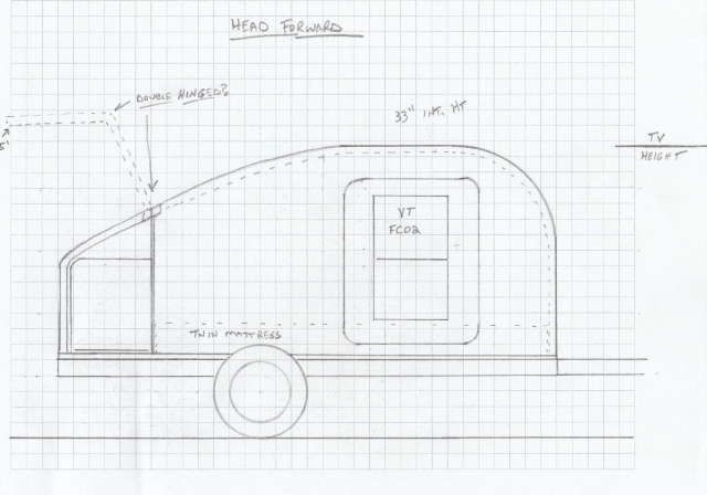

A quick sketch to address some of the suggestions. Keeping an eight foot length there's just enough room in the galley for needed items. Kind of like backpacking on wheels. 33" head height at doorway. Some space for cabinets above foot. Drawn with a 6" mattress. Finding a firm 4" mattress would make headroom even better.
Hatch clearance is a problem being only 5' high at this sketch position. Could swing it higher or maybe double hinge hatch. Changing the bulkhead to a "Z" configuration might help by having hinge forward compared to this sketch. Something to think about...

Postby Tom&Shelly » Wed May 24, 2023 6:14 pm
Yes, that'll be more aerodynamic. And it looks really nice as well. :thumbsup:

Postby tony.latham » Wed May 24, 2023 6:36 pm
33" means you can't sit up, which reduces the practicality of a camper. If the weather is nasty, we'll eat dinner inside.
A 4" mattress isn't thick enough. I had one in my first teardrop, and my hip could feel the floor when lying on my side.
Generally, in an 8' long cabin, the mattress space goes nearly all the way to the rear of the cabin--underneath the countertop.
:thinking: There's a reason the standard teardrop has--in a sense--ruled for eighty years. If you follow the generic Benroy plans here, you'll have a fine looking and fine camping teardrop.
But... build what you want.

Postby Pmullen503 » Thu May 25, 2023 7:27 am
TimC wrote:A quick sketch to address some of the suggestions. Keeping an eight foot length there's just enough room in the galley for needed items. Kind of like backpacking on wheels. 33" head height at doorway. Some space for cabinets above foot. Drawn with a 6" mattress. Finding a firm 4" mattress would make headroom even better.
The Z bulkhead idea not only gives you more height but moves the raised lip of the hatch forward.
