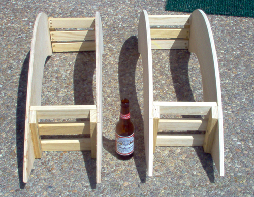

Yesterday, however, I finally got my fenders framed. They just need the top skins now. Andrew's plans called for a solid cross-piece to connect the two sides, but I modified it to use lumber that I already had. I hope he's not mad at me.
Here's a front view of them with my favorite beverage, and as you will see, my cross "spars" don't perfectly meet side to side. I think the tape measure must have been broken, because I know I measured and cut them all to the exact same size:

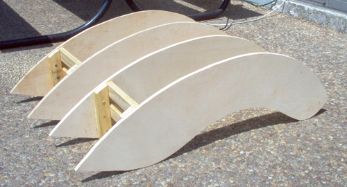

Here's a side view to show the profile, for those that haven't seen it. But what the heck happened to my beer?

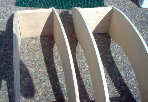

I then glued and screwed additional 1/2" ply to further strengthen it. Right now, I only did it on the insides of this framing. I really doubt it needs it on the OTHER side, but I'll probably do this overbuild anyway. (If I'm ever at a gathering with Gage and he gets on his back to look at the underside of the fender, he'll make fun of me that it's ugly.)
