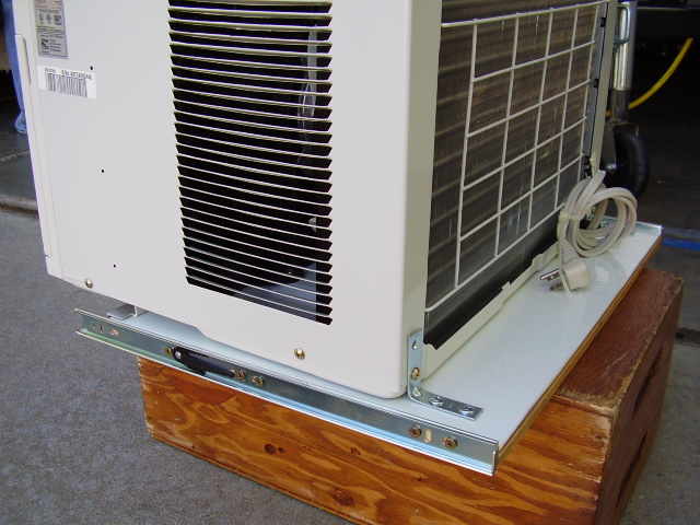

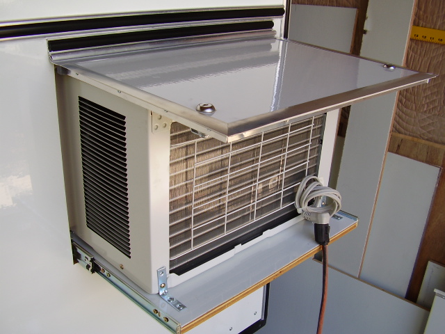

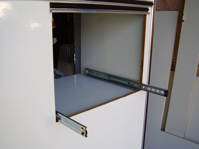

I decided that I wanted an A/C unit mounted in the front of my WeekEnder. But I did not like the fact that it would be sticking out the front during transport. So, I decided to find an RV Hatch that would allow me to mount the A/C Unit on a slider and secure it during transport and extend it while camping.
Here are some photos as I installed the hatch. I will update more as I complete the installation.

It only needs to move out about 10", so it will still be recessed into the cabinet when it is in the stored position. It is the 6,000 btu version as I wanted the remote and the digital controls. It is not much heavier than the 5,000 btu unit, but it is a little larger.
When stored, there is still enough room to place my ceramic heater in front of it.
Tongue weight is still not that bad. If it gets bad, I've already installed my axle so that it is adjustable. Both my tow vehicle are rated for 500 lbs. Currently it is onyl about 100 lbs. I'm estimating between 150 and 175 when complete.

It weighs approx. 40 lbs. I've cross braced it with 1X2 oak, the inside will have a center leg and the outside will be braced in a couple of places to the 1x3 spars and the 1/2" skin. Mounted only to the outside edges and with the 1x2 oak braces, I could sit on it with minimal deflection. (170lbs)
I will also use some 2x2x1/8 angle iron to mount the sliders. When the A/C unit is extended I will use a bolt and wing nut through the slider tray and the shelf. When it is retracted, the bolt and wing nut will also keep it stationary for travel so it does not beat against the door or rock back and forth.
I found the hatch from TRI STATE SURPLUS on Ebay for $40.00 including shipping.
