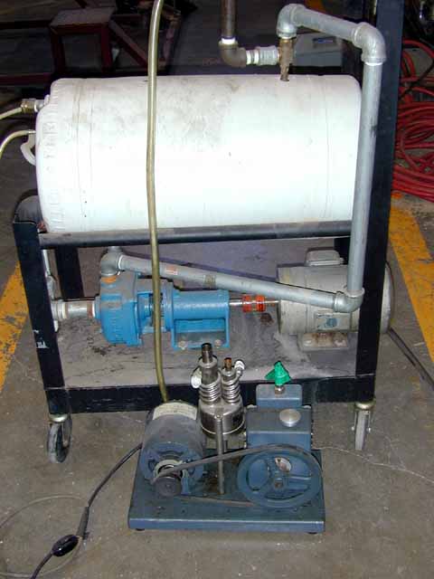

My setup used two pumps. I tried out a nice high vacuum pump, but I found out it only has 1cfm flow. I then hooked up our ejector/pump setup that I made for a project several years ago. It worked fairly well, except for not catching the leaks during the run. The ejector pump system draws around 20cfm at can do 28.?" of vacuum. Its a very big brother to the water aspirator that I posted earlier. I can post pictures when we get back, if you're interested.

I bow down before your wisdom and experience. :D I have never seen a comercial setup, and am coming to this from the "get it done in the driveway for minimal cost" point of reference. Both the ag bag and sheet polyethlylene plastic sheets I've used have been fairly soft, so they did form a decent seal. Not perfect, however. I'm impressed with your former bosses bagging.
Sam, the following is a pic of the two pumps I used. The big one is a home-made ejector we made up for a test of solar vacuum drying of materials. The second is a scrounged pump. (this is the one I was wondering if you wanted... shipping cost and its yours...1cfm, however)

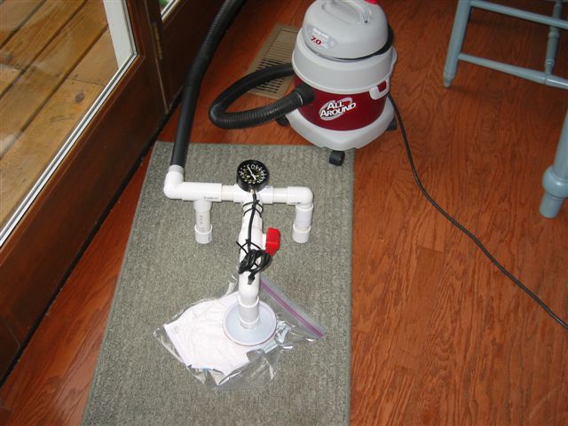

Between flying and my Honey-Do list I've only been thinking about this till yesterday. Still trying to figure a way to create a reliable laminated SIP to build my Teardrop trailer. Actually. I plan to make a modified Weekender first. Keeping all the surfaces flat, which is the easiest way to build an insulated panel, will simplify things.
I believe with the PL Polyurethane glue, I can make a very strong panel with about 2 psi clamping pressure. Especially if I roughen the luan and foam with a light pass of 60 grit sandpaper before applying the glue. I have tested my shop-vac and it can produce a 2.5 psi vacuum.
I headed over to Home Depot to see what I could find to:
1) attach my shop vac to a vacuum bag
2) trap the vacuum in the bag once it is evacuated
3) measure the vacuum to monitor it's presence

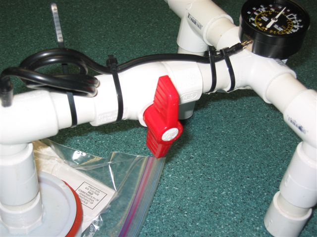

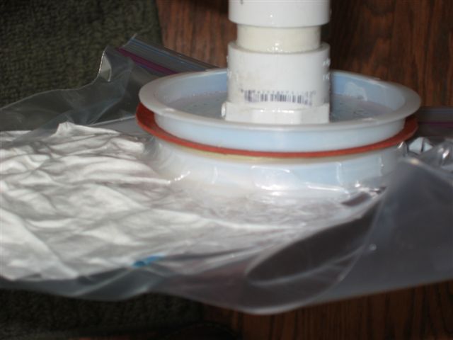

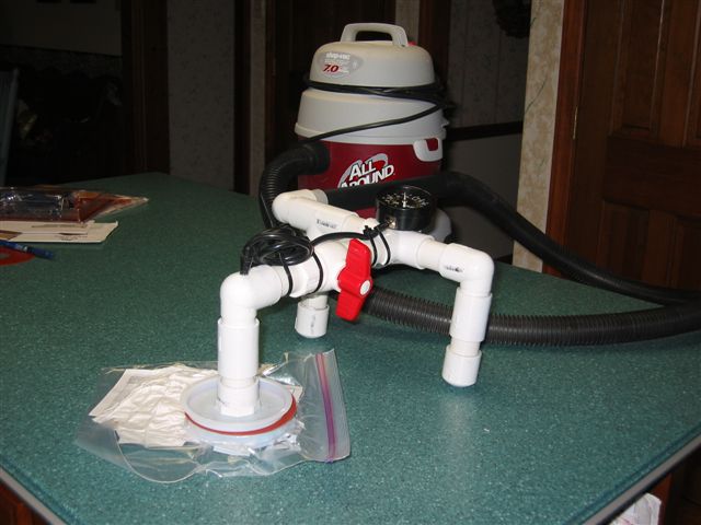

This is what I came up with:
As you can see I used a zip-loc bag to test the equipment since I needed to know I didn't have a leak with the bag. Unless I could assume some part of the system was leak free(the bag), I wouldn't have a clue if the other parts were working. I just threw a few pieces of mail and a sheet of paper towel (to act as a bleed layer) to see what would happen. I took some threaded PVC pipe fittings to clamp the bag between to flat PVC 4" test caps. I cut a hole and glued one to the top the lower plate is loose and held by a PVC nut ( a pipe fitting I cut off).
I used a sheet of rubber and plumbers putty to seal the outer surface of the bag. The results were pretty good. I held -5 in. Hg. ( -2.5 psi for a minute or two and the vacuum bled down to -1 psi in about 10 minutes. I want to get some tacky tape to see if I can seal even better. I feel pretty certain the double zip-loc seam of the bag was not a source of loss.
I admit it looks silly, but I added the legs to hold the attachment so that the plates would be parallel with the top surface of a vacuum bag when sitting on top of a panel in the process of being clamped.
I was concerned that I couldn't hold the vacuum and would have to run the shop-vac continously. I don't think the vac would manage that without overheating. The results of this test give me some hope. After reading Andrew's story about the guy transporting a vacuum bag across town and holding the vacuum, I figured it was possible. I have two shop vacs so I could rotate the two for cooling if necessary.
The vacuum guage was about $10 at Harbor Freight (note it is on the bag side of the shutoff valve to monitor how the vacuum is holding) so I got less than 30 bucks in the project so far. The bag and tacky tape may be the big ticket items if polyethylene sheet won't work. Is there any glue that will seal poly to itself?
Now I will try to build a super air tight vacuum bag that will hold a 4 X 8 panel. I will also try to see if I can improve the seal at the bag attachment. The closure of the bag end that needs to reopen may be difficult although I have seen how others have done it. I will try polyethylene sheet (6 mil) first, but may need to use vinyl to get a supertight bag needed with a low pressure source like a shop vac.
