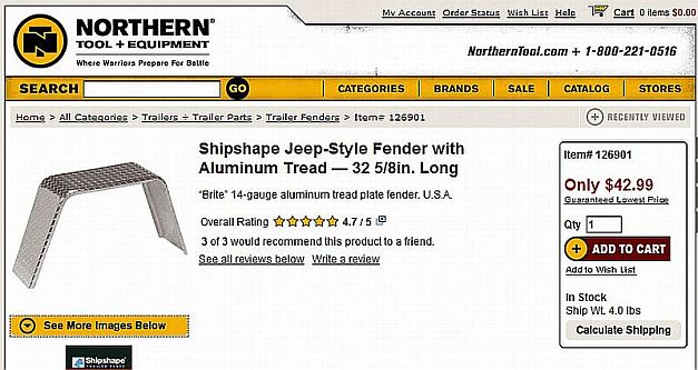

Postby Arne » Thu Aug 07, 2008 7:17 am
Aero-1 has to be ready by the 18th of this month. Given shipping times, had to figure out what to do about fenders.... spent a couple of hours and finally found several motorcycle trailers with nice looking diamond plate aluminum fenders on them... called one mfgr and asked about buy fenders from him.... he asked me; "do you see fenders for sale on my site"... I said, no, but was wondering if I could get a couple.....
He said, "northerntool.com" and hung up on me.....
So, went to northerntool.com and found these... and ordered a pair. They should be 'reasonably' simple to mount, and that is the last order of business out of the way..... They are too big, but hope I can cut the legs down to make them more presentable....

Postby Hoosier Greg » Thu Aug 07, 2008 7:37 am

Postby Arne » Thu Aug 07, 2008 8:05 am
I'll build some mounts from flat stock and bolt them to the frame. If I need it, I will put one bolt through the body at the underside of the top of the fender.. The bolt will be buried in the wall and not visible from inside.
If I do need the top bolt and can not locate it on a wall stud, I'll do something similar to the spare. I'll bore a hole in the wall and epoxy in a 1.5" wooden plug. Then drill and counter sink the bolt (stainless steel) and plug the top. Paint over it and it will become invisible.
