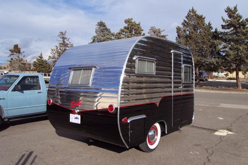

Postby shopfabricator » Sat Dec 27, 2008 8:25 pm
Could this Golden Oldie be the next one?
Aluminum Top, Painted Bottom.
...materials can no longer be purchaced at quite those prices mentioned here!
shopfabricator
Posts: 189
Images: 138
Joined: Fri Aug 24, 2007 9:51 pm
Location: Mooresville, NC
Postby steve wolverton » Sat Dec 27, 2008 8:34 pm
shopfabricator wrote:Could this Golden Oldie be the next one?
Yup, that's it. :thumbsup: That's the pic where I stole the little swoop from. I think I'd do full sides of polished aluminum. A black vinyl roof would really set it off. I know what everyone says about black roofs/tears, but they look amazing.
