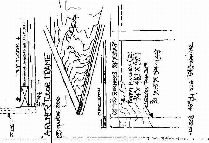

Postby GPW » Wed Sep 13, 2006 8:50 am
Here's a drawing of the floor frame that allows me to use all my 4'x4' Wide 3/4"ply scraps left over from the Bugout... Image
After all it will be bolted to the steel crossmembers of the trailer ... :roll:
Sorry about the post , that 's the only way I could get it to fit ...
