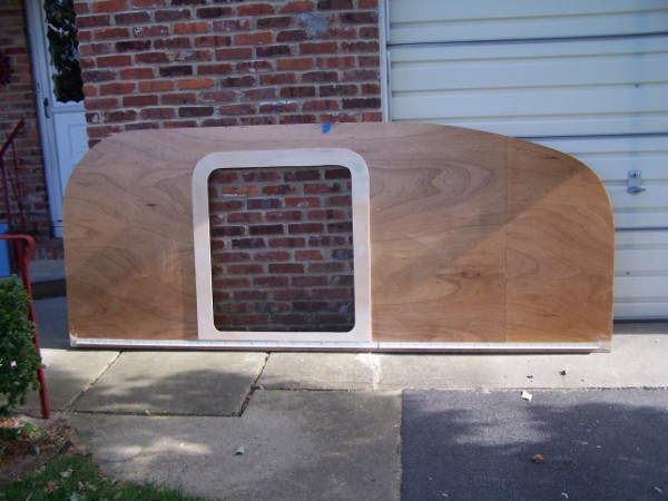

Pictures of the new hatch curve....
Postby kayakrguy » Mon Sep 11, 2006 3:29 pm
Hi Folks,
Took pictures of the 'New' Hatch curve profile--well more than just a new hatch proflle. We lost the 'Humpback Whale' feature and opened the curve a lot. Would appreciate your evaluations of the new curve's doability...
Thanks for your help!
Jim

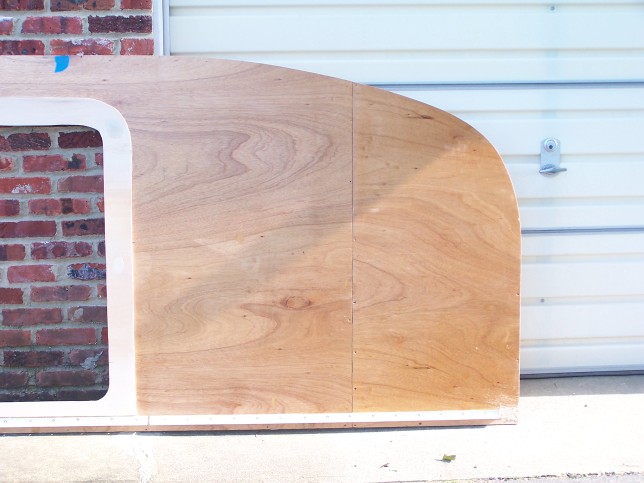

Second picture of hatch curve...
Postby kayakrguy » Mon Sep 11, 2006 3:31 pm
Folks,
I put two pics in the last post but only one came through...here is the second pciture of the hatch curve...

Ok, last try--second picture
Postby kayakrguy » Mon Sep 11, 2006 3:33 pm
Obviously I am still challenged by the pics thing....last try to get the second pic in a note...

Postby halfdome, Danny » Mon Sep 11, 2006 4:13 pm
That looks good to me. Good job :thumbsup: . Danny
halfdome, Danny
*Happy Camper
Posts: 5894
Images: 252
Postby madjack » Mon Sep 11, 2006 8:40 pm
Jim, it looks a LOT better...I lke whales ...but......is your hatch gonna start at the seam in the side,,,just wondering
madjack 8)
Posts: 15128
Postby mikeschn » Mon Sep 11, 2006 8:43 pm
It looks better to me. The sharp raidus on the back is gone!

Postby kayakrguy » Tue Sep 12, 2006 2:19 pm
Dan, MJ, Mike,
Thanks for your assessments. We took a little more off so that there is more of a curve starting just behind the door frame.
Madjack, your question is a good one. Today we seriously looked at the Hatch hinge issue. Let me recap.
1) Ideally, I want the hatch to be one piece of ply...(who doesn't)
2) but when I plot 48" on the curve it puts the hatch hinge way below the seam on the hatch wall.
3) we will dryfit the walls tomorrow and look at the hinge placement thingie then...it may be better with the walls 15" higher on the trailer floor.
4) Any thoughts about hatch size (and weight! gratefully entertained...
Anyone whose hatch builds have stayed at one sheet of ply--let me know how you did it...
