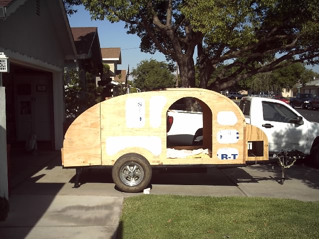

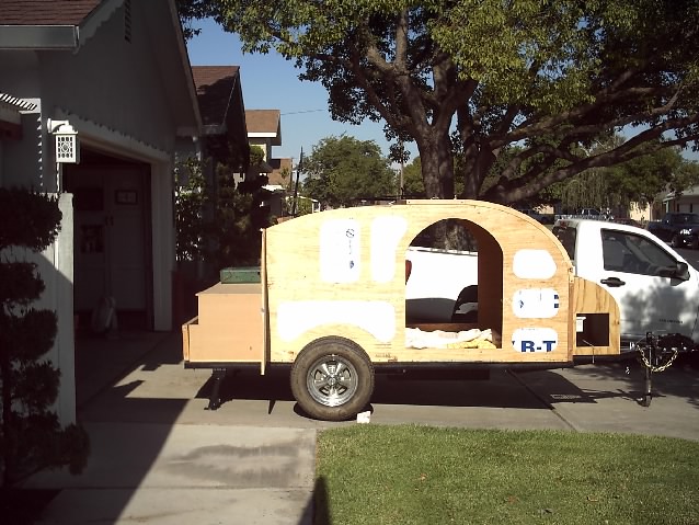

Hi Jim, My trailer is a 10’ on a 10’ frame. The frame is 1/8” X 2” angle, as light as I think is safe… I am relying on the galley cabinets for some of the strength in the back of the trailer… I will post some shots of the A/C next month, I am putting in massive OT at work now and won’t have time to uncover it. The bottom of the box is expanded metal and I will add 3” round boat vents on the sides at the top to let out the hot air. I am going to put a Honda 2k next to it under the box. The LED are backup lights for a truck and are from Del City. Check out www.delcity.net

I do have this shot of the AC on the inside, hope it helps. Dan
