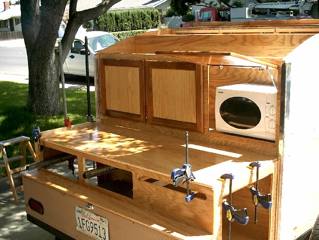

Gerdo, I made my doors out of ¾” x 2” Mahogany with ¼” oak ply panels. Strong, light and look like this…

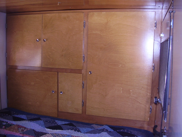

Gerdo, I was re-reading this thread and now I see you wanted to make your doors like mine. I think.
I used 1/2" Baltic birch for the doors.

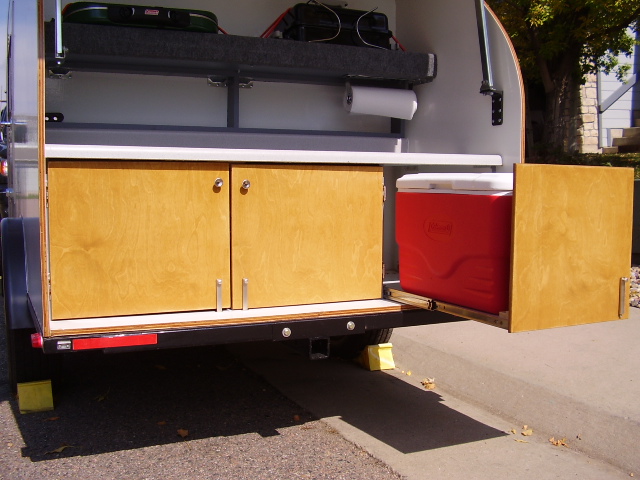

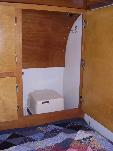

Postby Gerdo » Wed Oct 04, 2006 3:49 pm
I have some pictures to share now.
My Cabin Cabinets.

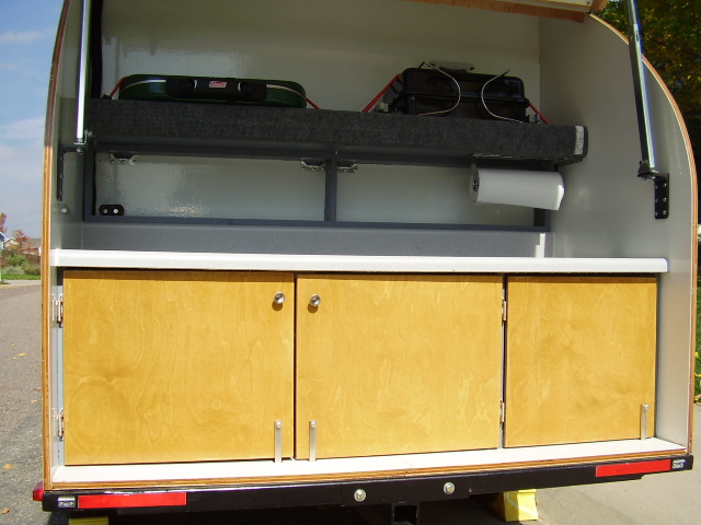

Our Cabinet that contains out PortaPoty.
Our Galley Cabinets, with the cooler drawer closed and open.

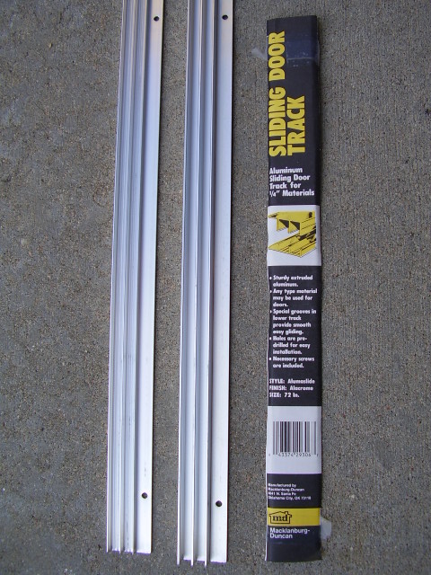

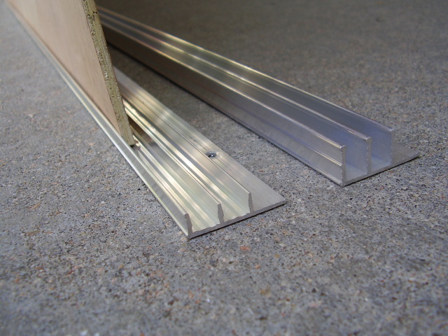

One of my next projects is to enclose the upper shelf in my Galley. I am using this aluminum sliding door track and 1/4" sliding bipass doors.
There are two different profiles. The taller profile is the top.

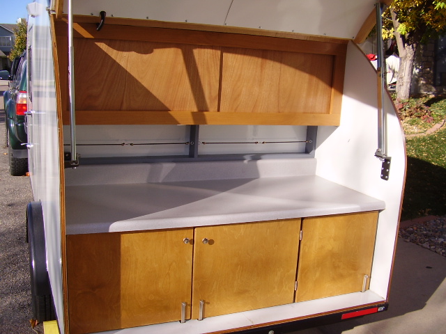

Postby Gerdo » Sun Oct 08, 2006 12:40 pm
Other than The Knobs that I will change out, My cabinets are done. I built and installed my upper cabinets in my galley.
And I built some shelves for in the cabin for books, DVDs, water bottles, glasses, etc.
