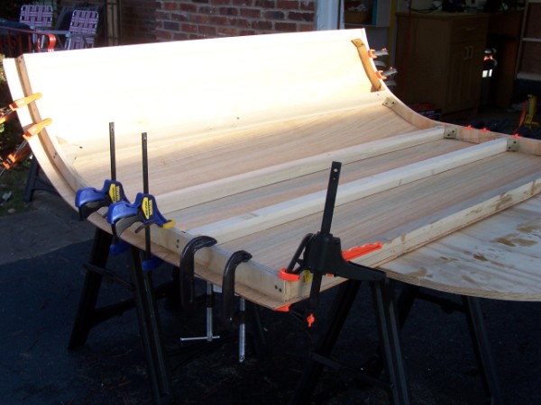

Postby kayakrguy » Sat Nov 11, 2006 7:01 am
Hi guys,
Slowed down...been on Red Cross RRV duty and this has been a bad week for fires....bad week for sleep, too :SH
Anyhow, we did manage go epoxy the outside of the hatch. :thumbsup:
Now, some questions:
The hatch skin took pretty well but I DO have some gaps on the ribs...can I put glue in there and will it and strengh if I do?
Brick, if gorilla foams if the fit isn't tight, are you saying urethane caulk will not? I am concerned here because the fit for the walls has to be pretty good :lol: or better, perfect :) to stay dry. I WILL fill with epoxy fill it after I put the roof down but still I want a good seal...
John, When I say 'messy' re epoxy I mean drips etc. I have been using acetate to thin the stuff and do clean up--do you know anything better?
Once again, thank you all very much!!
Jim

Postby kayakrguy » Sun Nov 12, 2006 9:52 pm
Hi Folks,
First, thanks for all the good pointers. I decided that it would be best to re-visit the hatch gluing. Having glued up the hatch in place in the hatch opening, I had to rely on the 1x2's which were ratched strapped into place to do all the work of providing pressure. That was fine on the spars, but not on the ribs.
So, yesterday I gorilla glued the hatch skin to the ribs and applied clamps...voila...it worked and there is good contact all the way around..
Having done that, we also put the last ceiling panel in place...
I also placed cleats between the ceiling and roof. Their pricipal purpose was to anchor the ceiling trim...which I put in today, finally getting it bent around the curve at the front FREE ADVICE: stain your trim, if you use it, but DON'T varnish it before putting it in....stiffens it immensely. Will send interiour pics later.
We found two auto dome lights at a local auto supply store--$8--they will be our ambient cabin lights--mounted just inside our doors for 'come home at night lights' They are incandescent. All our other cabin lights are LEDs
Tomorrow, I hope to run the wire to all the lights and vent, anchor the wires and be ready to mount lights and then it is on to the ROOF!
Weather is affecting build at this point. I actually brought the hatch cover into the house to finish drying. We have mild (50-60F) but very humid weather and quite cool at night. I now understand what everyone means about how slowly epoxy will dry in cooler/damper weather. It is supposed to be rainy for the next several days...
Still trying to decide between epoxy/urethane caulk for the roof mount. :thinking: :thinking: Just hope whichever I do does a good bond! :worship:

Postby kayakrguy » Tue Nov 14, 2006 3:27 pm
crux,
Sorry for the confusion.. :?
The outer skin was epoxied after gluing the skin on...used Titebond III.
The gluing took well to the spars...left gaps on the ribs....
I put gorrilla glue on the ribs, clamped those and got a good adhesion.
Next, I am going to epoxy the INSIDE of the hatch...both to seal it and to get additional adhesion. Besides, I am using bendy birch and the epoxy will stiffen and strengthen it.
When all this is done and the roof is on (and epoxied). then I will paint.
I haven't done anything specifically directed at UV yet...
Hope that helps...
Jim

Postby kayakrguy » Tue Nov 14, 2006 6:51 pm
Crux,
Well yes, ox ribs, actually :lol:
The ribs are those curved pieces at the outside edges of the hatch cover.
The straight stuff are the doubled 1x2's. The ribs are cut from 3/4 ply using a pattern made from the curve of the walls onto paper and transferred to the plywood.
There was no intention to use gg and titebond separately on the spars and ribs. If the original effort had worked both the spars and the ribs would have been titebonded to the skin. However where the titebond did not take, I simply scraped most of it off and used gorrilla glue because I thought it would be able to get a good bond over any residue left on the ribs, skin. And, it seems to have worked fine...
