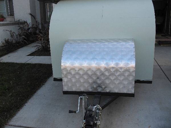

Postby dhazard » Sun Feb 04, 2007 8:20 pm
Side one is done!!!

Postby doug hodder » Sun Feb 04, 2007 8:25 pm
Looks great Dan, just for everyones benefit...how long did that panel take? One awesome tear in the making, that's for sure!!! 8) :thumbsup: Doug

Postby dhazard » Sun Feb 04, 2007 8:43 pm
I think about 2 hr to designee and build the jig. Only about 6hr going in 4 ½” circles.

Postby doug hodder » Sun Feb 04, 2007 8:54 pm
I figured as much...and for anyone wanting to do this, if you screw up, you need to go back to the line prior to the one you just did and start over, as they all overlap and you can't just "doctor" it up in the middle...doesn't work like that if you want the full effect...that's one thing that drives the time, make sure everytime it's right where you want it or you run the risk of losing a lot of ground.... :cry: Doug
Postby dhazard » Sun Feb 04, 2007 8:57 pm
I did have to back up twice. :oops:

Postby dhazard » Sun Feb 04, 2007 9:41 pm
Some more info for anyone crazy enough to try this. I didn’t count the sandpaper sheets when I changed them out, but I think I did that side with about 15 disks. Most of the disks were damaged on the edge of the aluminum. They would get torn on a burr, one time It hooked so bad that the scochbright pad was destroyed, and had to be replaced. (The pad is between the sand paper disk and the backing plate to keep the grinder from hopping.)

Postby doug hodder » Sun Feb 04, 2007 9:48 pm
Dan...just for my cabinet doors I bought a jar of 50 2" disks to do it all. I'd imagine that with a 4.5" disk you're going to blow through as many...I'm turning slower than you however, so don't run as much risk of damage to the edges, my issue is that they load up pretty quickly, even with cleaning them out with the crepe rod. doug
Postby dhazard » Sun Feb 04, 2007 9:54 pm
I cleaned the disk every 3rd drop, and had very little problem with loading up, just tearing.

Postby dhazard » Sat Feb 17, 2007 9:03 pm
Worked at making more circles today. :? Had to see what it looks like outside in the sun. 8) This took about 2hr and 3 disks. ;)

Postby doug hodder » Sat Feb 17, 2007 9:07 pm
That really looks choice Dan!!! :thumbsup: :thumbsup: good job, when does the rest go on the side of the trailer? :thinking: Doug

Postby dhazard » Sat Feb 17, 2007 9:16 pm
doug hodder wrote:That really looks choice Dan!!! :thumbsup: :thumbsup: good job, when does the rest go on the side of the trailer? :thinking: Doug
At the pace I am going, I think it will be about 4 more weeks. :? :? :?
And I think another case or two of Guinness
