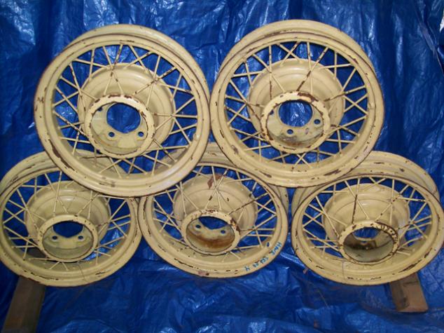

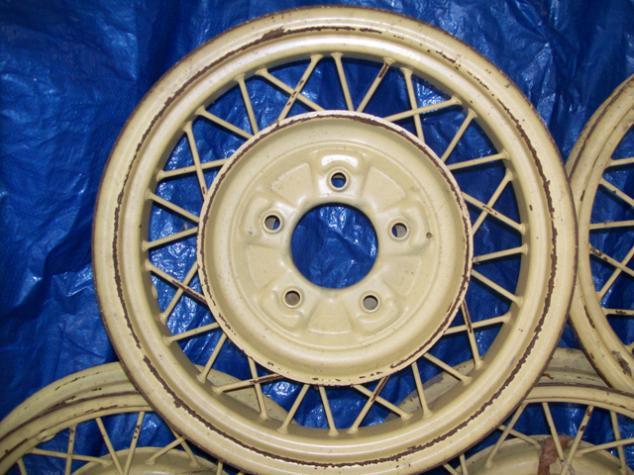

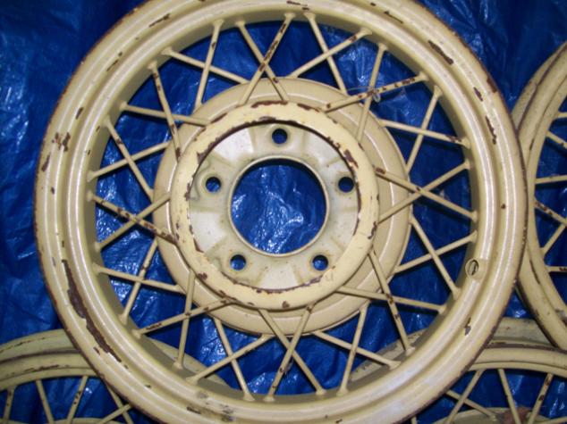

Postby Bob Olszewski » Wed Feb 07, 2007 8:24 am
Finally got the picks of my 17" Ford wire wheels. Take a look!
I said before It's $40/wheel + shipping for all 5 wheels, be it someone takes 2 wheels and another takes 3. But if 2 of you folks only want 2 wheels each, the price will be $50/wheel + shipping. I need to get back what I put into them. I'll keep the fifth wheel as a spare for my build.
