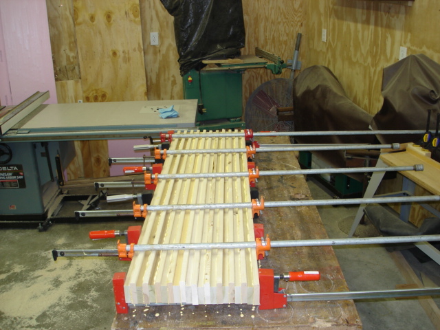

Gerdo-HOLY SMOKES - MAPLE???? Now that is very nice wood, very strong, very hard, but crazy heavy and even crazier expensive. I use Maple when building furniture, it's wonderful to work with; my budget will not allow that, epecially for something you "wont see".. but :thumbsup: to you for using some great stock. Mine are 1x4 Pine glued to 1x3 Poplar, 12"oc/6"oc on the radius, finished size should be 1.5"x2.5".
I'll do the hatch in doubled 1x3 oak.

I'm wondering, is a 2x2 roof spar stronger if it's glued up from 2 peices of 1x2?

Steve B... yes it is. That's why laminated beems are so popular for floor trusses in homes and they got away from 2x12's from the 40-70's building codes. Grain will run "diagonally" when looking at the end grain. If you can glue up the boards where the grains go away from each other you'll also minimilize twisting. Also.. 1 board could have a slight split in it.. .that spilt WILL go the full length of the board in a given time, if you use two boards you stength that. They also state, the most stength is when width is 1/2 of the height or greater... i.e. a 1x is actually 3/4 x 1.5. The strongest truss you could build for a TD would be 1/2" osb encased in "real" lumber, much like they use for door headers in homes, but there just isn't enough room to do that, plus, I don't think it's AT ALL necessary. The TD egg shape will resist sagging in itself, just by design.. I'm just "beefing" mine up because I have about a 6' flat section. Oak is strong, but thanks to the advise of this forum I am comfortable with the pine/poplar combination. I can build a home, but the TD is kind of an art in my opinion.. maximizing weight, material and shape to = strength, so I REALLY trust the guys on this site... they've done it and it's my "newbie" luck to hopefully benefit from their successes. I don't wanna build a house, I wanna build a TD :D
